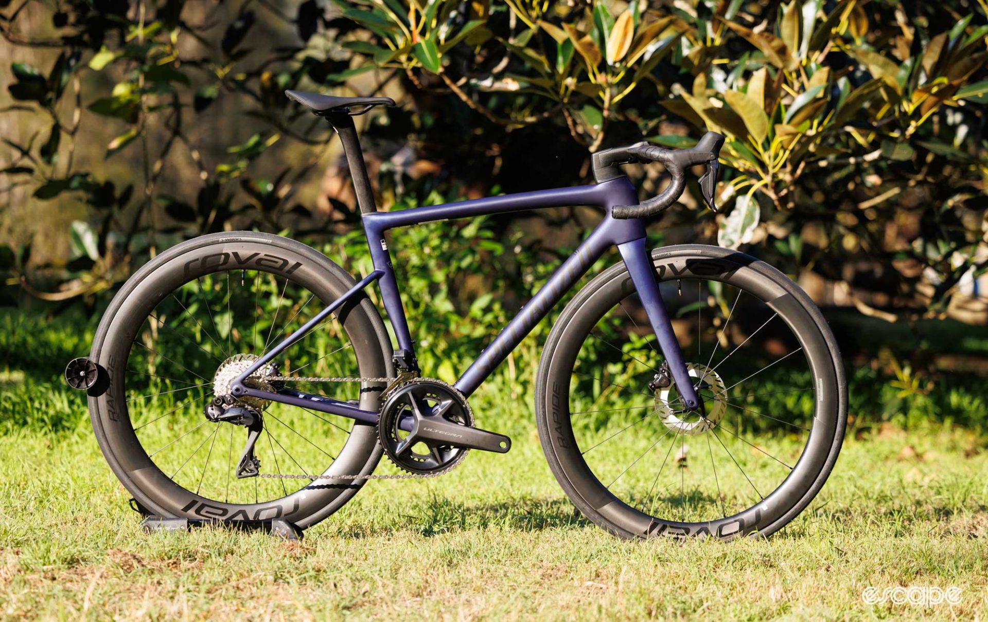

I finally got my size 52 pro frame in and built her up. Not a bad race ready weight with just ultegra and no super light tacky sworks stickers :joy:

It has yet to arrive, but the workshop already posted about it. Super stoked to push it up and down the mountains of Gran Canaria the next two weeks.
Should come out to a nanogram under 6.3kg with pedals, computer mount and bottle cages. Size 58, Cockpit 115/380
With those wheels you’re going to have to change your name to lightiseverything :wink:
Impressive weight for a size 58 :partying_face:
Congratulations, enjoy in good health👍
No worries. Just for GC. When I’m back home the 6.7 are mounted back on.
Better pics (and of course ride review) to follow.
Maybe because it’s a 58cm frame, but for all the hate the “speed sniffer” got at first…I think this looks great! One of these days I’ll have the SL8 Expert in gloss pine green (one can dream)
It looks good with the Rapide Cockpit, since they’re different spacers. Looks horrendous with the regular stem, unfortunately…

Full List:
S-Works SL8 Frame, Size 58 (Color: SATIN CARBON / VIAVI CYNAN BLUE / VIAVI SILVER-BLUE PEARL EDGE FADE/GLOSS METALLIC WHITE SILVER)
Cockpit: Roval Rapide 380/115mm
MagCAD Wahoo Bolt Mount (yet to arrive)
CeramicSpeed Coated BSA BB
R-Works custom RD Hanger
Shimano Dura Ace 9200:
Standard STI shifters + sprint shifters
SRM PM9 Spider Powermeter with 24mm titanium Axle and THM Crank 172.5mm
Standard front and rear derailleur with CS OSPW with Golden 3D Printed Pulley Wheels
Rings are 52/36 with an 11-34 cassette (for the mountains / I have a 54/40 11-30 option, which I’ll be using more frequently at home)
XTR Chain, Waxed with Hot Melt
ENVE 2.3 rims laced to DTSwiss AeroLite spokes and Extralite Cyberdisc SPD-3 Hubs with Ceramic internals
Carbon Ti SteelCarbon 2 Disc Rotors (160 front, 140 rear)
Continental GP5000s TR 28mm Tires front and rear
45ml of Orange Seal Standard front and rear
Darimo Straight 380mm seatpost
Selle Italia Tekno Saddle (95g)
Carbon Works (not Princeton) Bottle Cages
Speedplay Nanogram Pedals (pre-Wahoo)
Supacaz Bar Tape (Star Fade Platinum)
If I forgot something, just ask.
