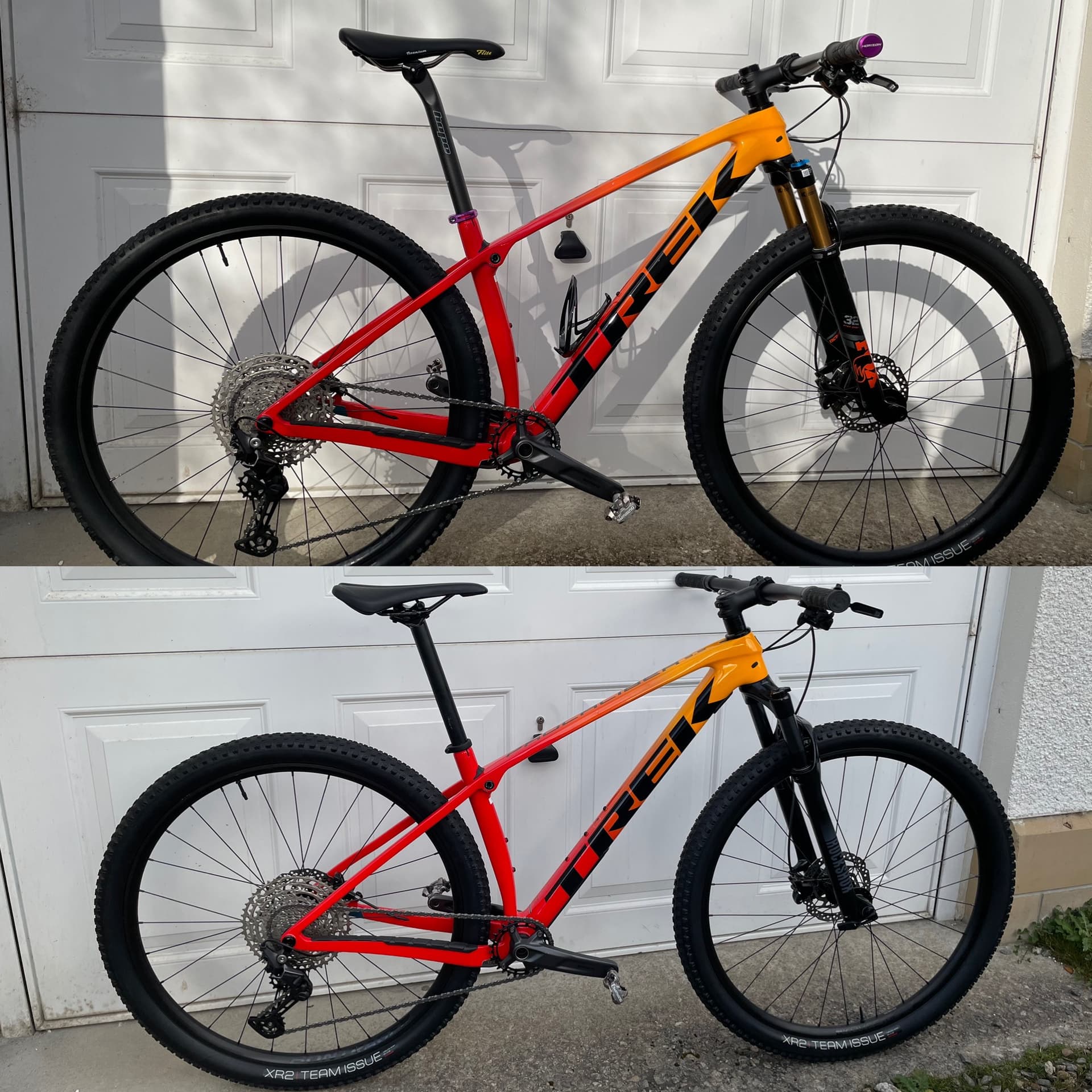

I’ve just done the same exercise with my XC bike, with a similar budget (albeit £1500). I splurged on Ritchey carbon bar, Hope carbon seatpost, Flite Ti saddle and Fox Factory 32 Step Cast forks. I couldn’t find and XTR cassette, but that’s next on the list.
Have you installed the Richey bar?
Yes, I’ve installed it.
Do you like it? Have you noticed any changes in harshness?
I never rode the bike stock so can’t say to be honest. I do like the bar - suits me in terms of rise and sweep. I’m able to dial in a comfy position. Yeah, I like it. Looks great too!
Do you have pictures of them and the build so far? (Maybe on the TR Users bike thread? TrainerRoad users' bikes)
I’m still very tempted by some carbon bars. I have 7075 Syncros bar and stem though so in order to drop weigh I have to spend a lot of money. I like the idea of extra comfort/compliance without degrading handling, but I’m nervous about the additional risk with the clamping during reassembly post travel…
First and third pic is midway through the build before I fitted the forks.
