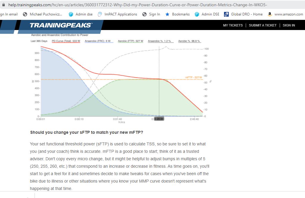

Really look at the pic or open the corresponding graph:
PD (power duration) curve = anaerobic (frc) + aerobic (ftp)
There is no anaerobic contribution to ftp, the anaerobic system only produces lactate, it doesn’t clear it

I have but perhaps you have a link. I think that what Cusick and Coggan think is the real clever part of their power duration model is how it can distinguish between the aerobic (ftp) contribution and the anaerobic contribution (frc) at a given duration

When opened my laptop I saw reply notification again. So I googled the explantion from WKO5, (m)FTP is strictly aerobic
https://www.youtube.com/watch?v=w045U0zTkgs (explicitly mentioned around 2:06)
