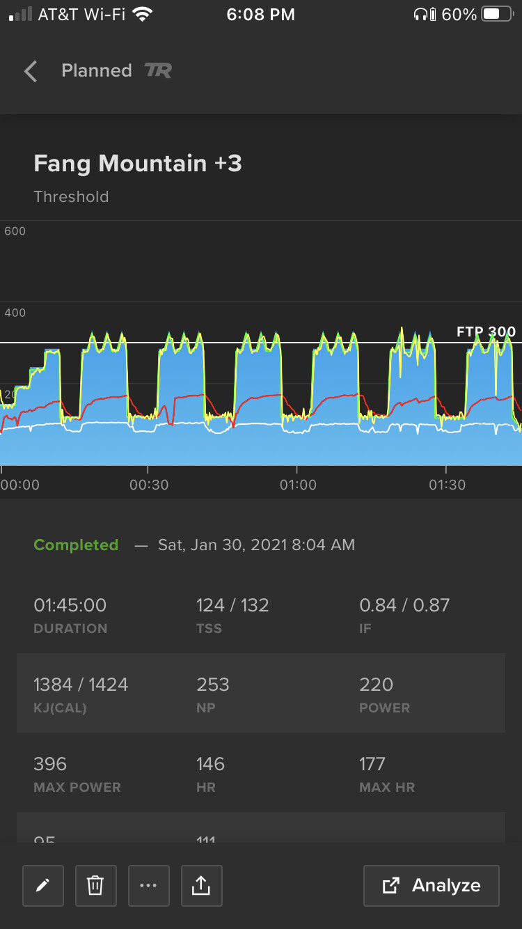

Thanks for the thoughts I’ll post some screenshots here of recent stuff from the last two weeks. Avalanche spire was this Saturday and my Tsb was +15 after having to miss Thursday. The other 3 are the only real intensity workouts I’ve had so far (and hunter which is easy for me and I actually did mills really well). The workouts were all preemptively turned down 2-3%, since I felt it was going to be jarring to go from just sweet spot to over threshold work. So hopefully I can get my mojo back, I was really motivated and doing well through base, and was hoping to nail some higher power before returning to base to prep for CX season. Im personally ok with lowering the target if it allows for greater consistency, even if it isn’t pushing me to the absolute limit.
