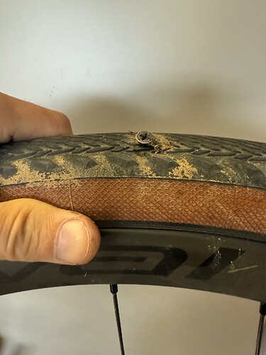

Noticed a screw that has been in my back tire this weekend. I am not sure how long this has been in the tire but the tire never lost any air pressure. I had a plug ready to go when I pulled the screw but it sealed right up with no plug. I will be sticking with the new Silca sealant as I am a happy customer.

How did you not feel / hear that screw?
It was far enough off center that I didn’t feel it when riding. I believe I picked it up in a spot earlier this year where there was some debris on the sidewalk and I got a hole while riding which I plugged. What is crazy is the plug is almost in the exact same spot but just on the opposite side of the tire where the screw was.
Also, I did deflate the tire afterwards and check the inside of the rim which luckily wasn’t damaged.
