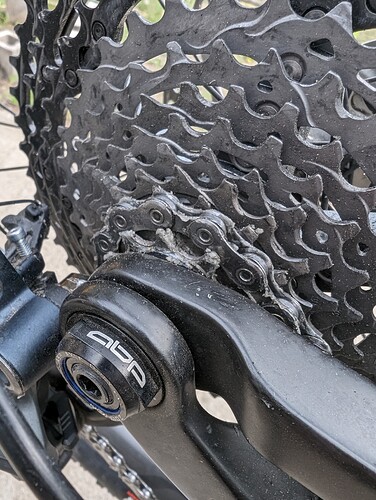

Tried it for the first time and after the ride I have gunk on my chain, cassette, chainring and jockey wheels. Any tips on getting it off? Been trying rags, and plastic bristle brushes but not having much luck
How long did you ride? I find any residue just wears off on a longer ride.

is this wax? boiling water is ur friend.
Won’t that take it out of your chain?
It is excess wax. Wax is the lubricant you want. Dirt has a much harder time sticking to it. Unlike wet lubes, that buildup won’t hurt anything. Just looks like it will. Once a month I will take a q-tip and clean it off my jockey wheels. With the wheel off you can wipe off the cassette and run a folded rag between sprockets. Tossing the chain in boiling water will remove some wax and any dirt. Then hot wax again.
It’s silca lube wax, not hot wax
It just flakes off. Nbd. Jockey wheels collect a lot offer a season but still nbd.

It is still wax. It looks dark because of the tungsten dioxide they put in it.
probably not, but if the flaking off bugs you, then use a microfiber cloth or something similar to wipe the outer parts of the chain, this is the most likely source of flaking and does nothing to lube the chain. The only time the flaking bugs me and then very little is on the trainer, and the flakes can be vacuumed up.
also did you wipe the residue after applying and spinning?
Yes I did
