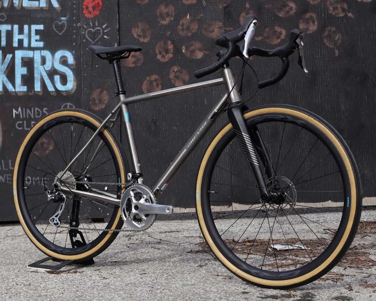

Yup, snagged a 2x setup via good Pro Deal and have it planned for my pending gravel build. Currently aiming towards the All-City Cosmic Stallion Titanium.
Found another person who made a build very similar to where I am headed:
When your name is Ben Delaney? :crazy_face:
I can cut him some slack in this regard, though…he probably shot this “on the fly” and didn’t have a lot of time to make notes, double-check everything as he was doing the vid. he at least made the corrections in the video once he released it.
