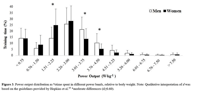

Cycling pros do high volume at low intensity AND plenty of no-man’s land tempo/SST. Just one example, a 4 year retrospective analysis of Team Sunweb’s (men and women) intensity distribution. A typical pyramidal distribution.

It does not look pyramidal, when you consider that these athletes have FTPs in north of 5.5 W/kg. Let’s look at the table if it was expressed as % of FTP and assuming that athletes have on average FTP of 5.5W/kg (it might be lower for sprinters and bigger guys and higher for smaller guys and GC/mountain type riders).
Does it look pyramidal? Because it does not for me.
You can call it whatever you want, key for me in this entire discussion is that they do not avoid any intensity levels.
I believe, you were the one calling it pyramidal :smiley:
What I am saying, is that most PROs or cyclists with enough time to train seriously do most of their riding at intensities below 75% of FTP or so. In that sense, I agree with polarized approach. I also think that some riding at SS/tempo efforts are also required. Even more of that if target event specifics require it. So, overall, I guess we have similar ideas about training.
I do not, however, want any reader of this thread, come, look at the chart provided from you (I have read the source study as well) and go “Whoah, PROs training distribution is pyramidal and they do most training at middle intensities”, because that would be misinterpretation of the chart. Hence, the same chart expressed as % of FTP to display, that while it might look pyramidal from first glance, in reality it’s not and most training time is spent significantly below threshold.
I guess we have different understandings of what pyramidal is. I follow the definition by Stöggl 2015 [1]:
For me the chart is straight cut pyramidal.
However, as already alluded to before, I find this absolutely irrelevant how we label it. This distribution is clearly not polarized.
[1] The training intensity distribution among well-trained and elite endurance athletes - PMC

Yep. What’s a typical pro’s LT1 - maybe 80% of FTP? Easy to see that they log a lot of time in zone 1.
That would be a strange looking pyramid all fat in the middle and no base… but one thing that is true about pyramidal is that there is more middle intensity than high. Seiler admits as much and only holds on to the 80% rule for cyclists.
