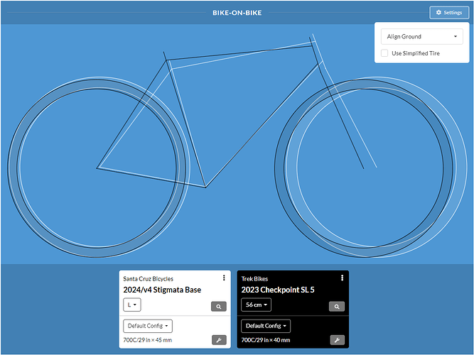

Your Checkpoint is still 20mm shorter wheelbase and 2.5 degrees steeper than the V4 stiggy though.
I thought you had a RaceMax? Did you get rid of that? Too much like a road bike and want a gravel bike that’s more gravel? Ventum GS1 is a looker.
Yup, quite different bikes WRT Front Center and Head Tube Angle.
The Checkpoint is sort of an odd duck with a steeper head tube (72.2*) but longer reach (as compared to common road setups) while still shy of the Stig in many ways.
On the topic of all these bike geo comparisons, it’s interesting how the basic geo on paper may be super similar and the ride characteristics be so different. I went from a pure XC race bike (2013 Jake the Snake) to the V3 Stiggy and even though they are super similar geo, I MUCH prefer the Stiggy. I don’t think it’s just because it has disc brakes either :rofl:
Tire size, fork offset, steering trail, just a few MM really changes a bike.
Had a RaceMax. Crack in the frame a month into riding it. Received a replacement frame that was slightly out of spec and 2x chainring bolts rubbed the frame under power. Frame would likely have been fine with 1x, really tight tolerances. At that point 3T went completely dark on me so I returned it to Excel Sports. Some other stuff and let’s leave it at a bad experience with 3T North America.
Sure, there is more to it than these numbers. A single change in tires can make or break a bike. Add in stuff like handlebar reach & drop, hood reach/shape, final saddle position (fore-aft specifically, if there are limits like offset post in one case vs none in the other) and you can get vastly different layout on bikes with similar (or even identical) geo.
Heck, changing the spacers under a stem and/or stem length by 10mm is enough to alter the feel and performance for some people. But all else being equal, this process of chart comparison can shed real light on the how’s and why’s of bike handling.
