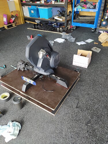

  • Decent plywood of at least 1/2" [12mm) thick, and hopefully closer to 3/4" {18mm] is plenty strong to support on the 50mm vibe mounts.
  • I haven’t built with this specific version but a decent flat head screw should be fine to prevent pull through. If you want to use a regular nut and washer, just add rubber feet to the underside, at tall or taller than the screw and washer height. I’d recommend placing a bit of tape or rubber (like scrap of old tube) over the hex head if you plan to use the rocker on a hard floor, for protection of the floor if the deck flexes to contact the head to the floor.
The wee fella and I had some fun throwing this together this morning after his Covid jab (so was home from school).
Really happy with how it came out though it was more of a rush than planned.

Right on! Looks like a great build :smiley:
Thanks :grin:.
I can’t wait to try it out. Riding on the trainer at work for the next two sessions. Hopefully I can get out to the garage on Sunday just for a tune up before back into SS on Monday.
I was pleasantly surprised how much flex was in the dampers. I thought they’d be a lot stiffer, and possibly more difficult to fit.
I ordered one of the little hand pumps with the gauge that was posted a few posts ago. That will help.
I have an uneven pedal stroke, that I’ve always known about as my left leg alignment isn’t quite as good as my right. I will have to work out how soft is ideal. Even spinning with crocs on seemed like an improvement in saddle comfort, though that could have been optimism.
