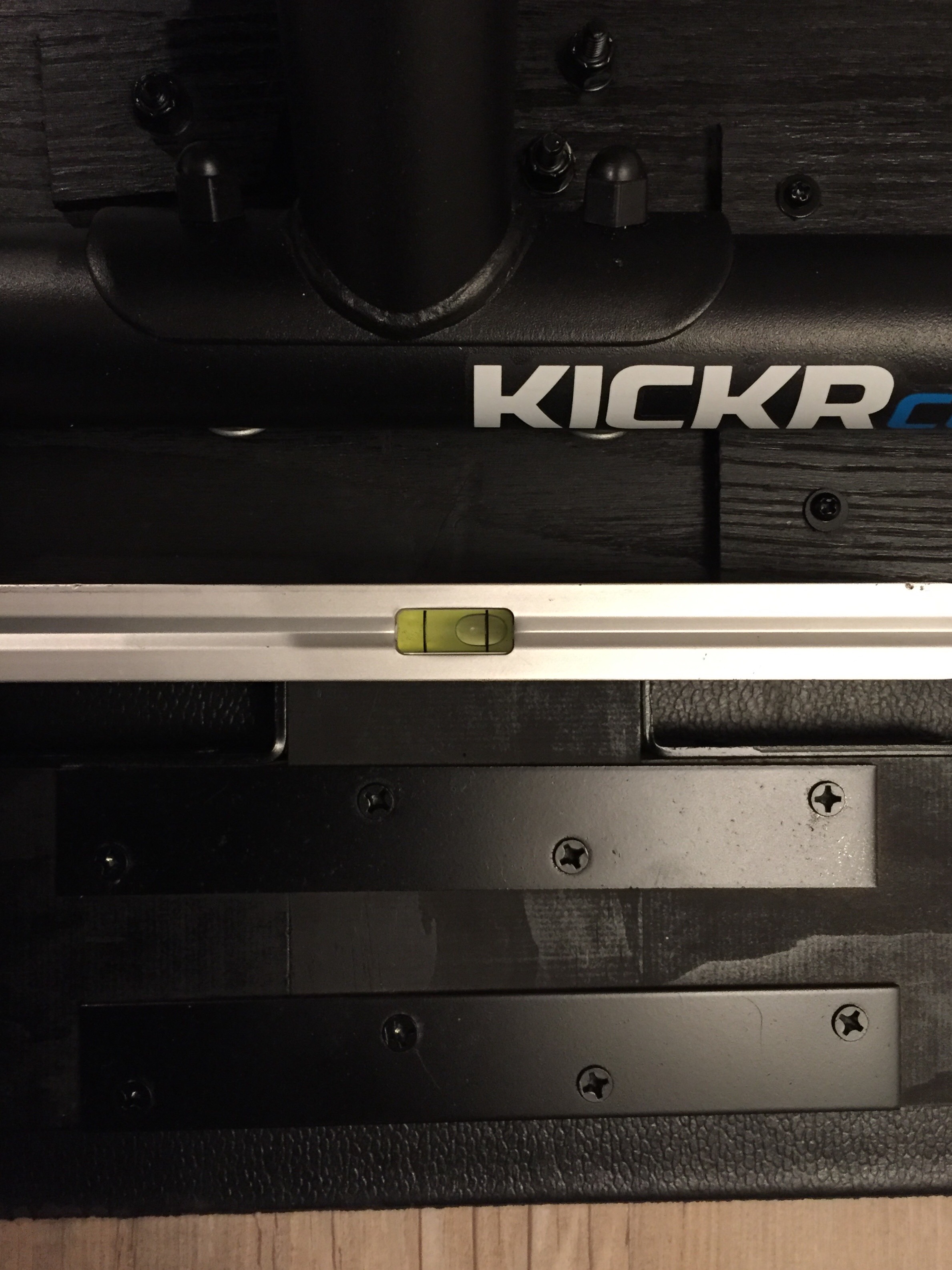

Hey Chad! I finally built my rocker plate with the kickr core. Replacing the metal legs to function as a top deck wasn’t doable and would have required a lot of woodworking. So I modified your design and used tee hinges below the deck.
I’ll send photos of the finished product soon, but I’m having trouble centering it on the top deck. I centered it with my bike attached, above the pivot point using a plumb bob. But with my bike off, there is a significant left sided weight bias. Photo attached with my level. Is this acceptable? Thanks!
Can’t wait to see the finished product.
Do keep the bike dead center over the pivot axis. Then the best is to add a 10lbs weight on the right side of the deck, at the outer side. This is a near perfect balance for most trainers and flywheels. You can fine tune the weight position to get it just right (or add weight if 10lbs is not enough).
Then you use equal pressure in the springs and it feels very even,
