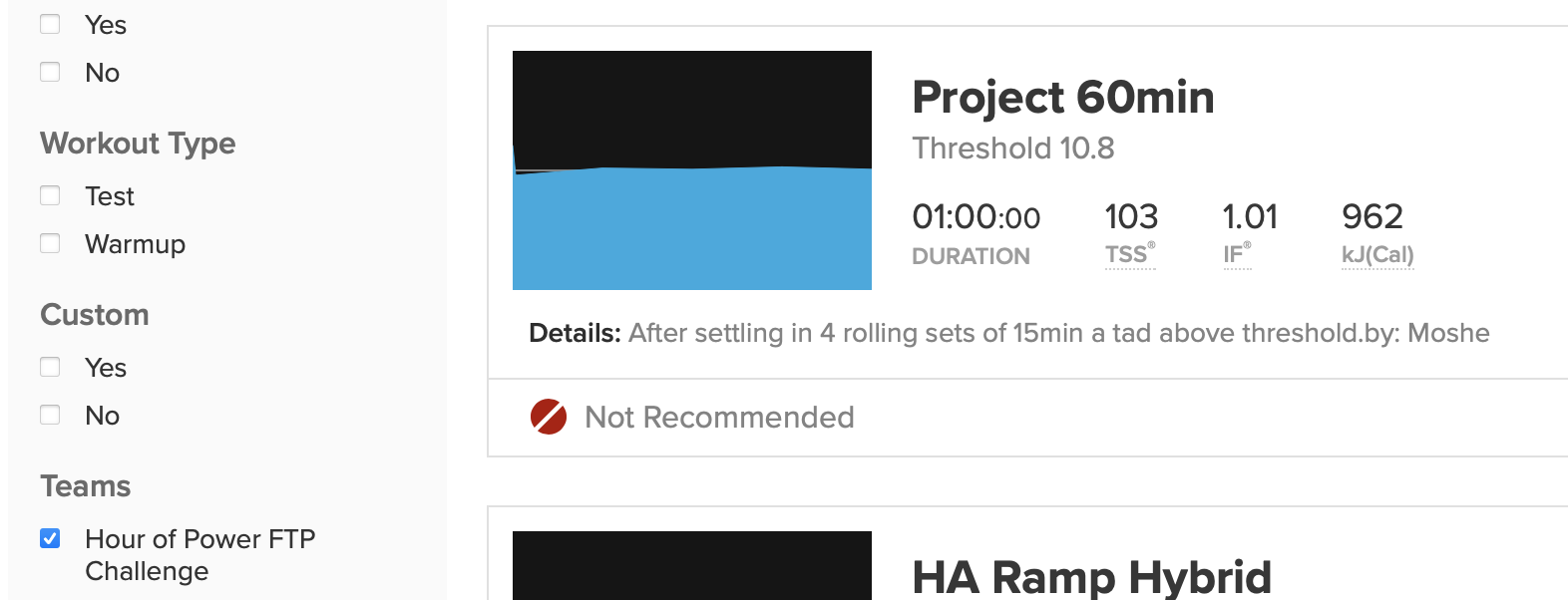

So you could do something like this workout:
by feel, or adjust intensity in erg.
