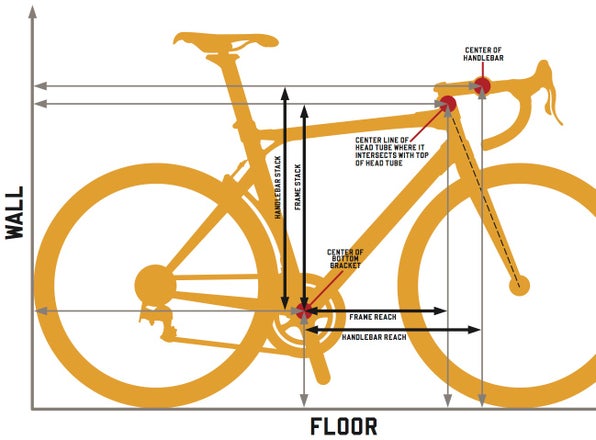

Using a tape measure and plumb bob, I have gotten the two fits pretty close, but not exactly. I’m having a particularly tough time getting the saddle setbacks to match using just a basic plumb bob and tape measure. Does anyone have suggestions for tools I could use that don’t cost $295?
I am thinking a basic adjustable drywall square would work, but I would need to rig something to anchor it to the bottom bracket (or floor). Any ideas?

Taking center point of BB using plumb bob and marking spot on floor, doing same for saddle nose, marking on floor, measuring between the two points. The bike frame tends to get in the way of the plumb bob when marking the spot for the saddle nose. Another complication is that bike A is a TT/tri bike, bike B is a road bike with a reversible seatpost, so can’t use seatpost as a reference point really.

Try a doorframe (or a corner of a wall). Lean the bike every so slightly and move the bike so the tip of the saddle hits the edge of the doorframe/corner. Then measure the distance from the bottom bracket to the same edge of doorframe/corner. If you have the bike perpendicular to the corner, the sideways lean of the bike won’t affect the fore/aft position of the saddle/bottom bracket. Repeat this measurement 4-5 times and take the average. You’ll be within a millimeter or two of the “correct” number.
