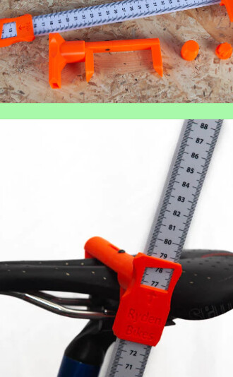

I picked up one of these fitting tools from Ryden Bike.
It’s super handy, and includes a jig to find the 80mm section of the saddle, precisely measure from there to BB center (with adapters for different cranks), and a little tool to measure from saddle waist to hood tops/troughs. I’ve used it to replicate fits across several different bikes with good success. It’s all 3D printed and plastic, but it works well and I think the price is reasonable.

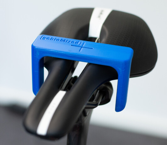

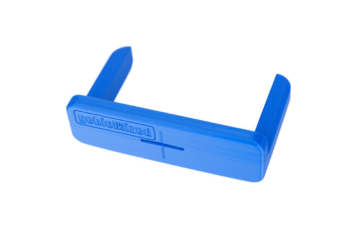

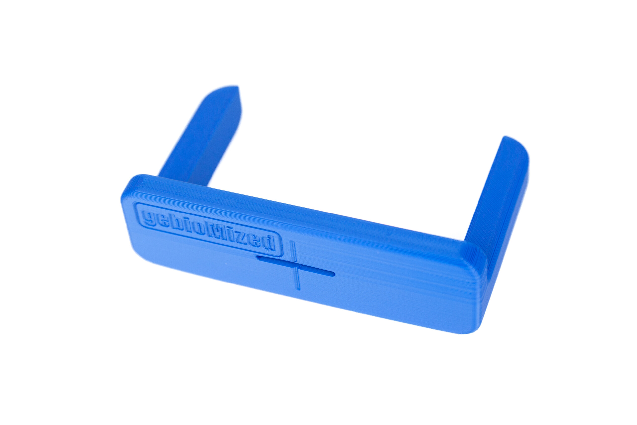

Just to add some pictures & info to expand on the tools some people use with this mid-width location.
The Ryden tool mentioned above, is also adjustable width:
