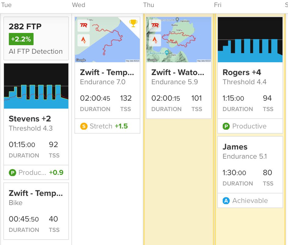

First of all TR’s recommendation would be to take a rest day if you have a red day. And I am assuming if this was a TR plan then it would have adapted the red day to be a rest day.
Since the workout is scheduled on a red day I would have to assume that you either manually scheduled the workout or declined a RLGL adaptation.
Either way the workout’s rating is moot. The TR recommendation is to rest.
PLs are agnostic of RLGL. These two systems (RLGL and PL), for all intents and purposes, don’t know each other.
The ā€œachievableā€ rating for the workout is just displaying what that workout’s PL is relative to your current PL for that zone.
A new feature set which could be compelling is to have your PLs dynamically change (or lower) if you are on a yellow or red day. But I think that potentially would be a scope creep for PL.
So did TR recommend the workout for the red day? I think this is where @dubrose40’s question is relevant.
Correct me if I am wrong but since RLGL’s behavior is to adapt that red day to have no workout I believe you manually scheduled this workout. If so there is no contradiction because you essentially overrode RLGL.
The bolded part of your post I quoted gets to the point of my post. Yes, today RLGL & Workout Ratings are independent, but that creates contradictory recommendations back to the rider. That’s all I was pointing out.
I disagree. Adaptive training would simply suggest an adaptation to make a red day a rest day or a yellow day to a lower level endurance workout. If a user is following a TR plan and adhering to all adaptations then they hypothetically would never see a workout on a red day.
Except this isn’t a true statement as adaptions at the moment aren’t automatic. Plus you are discounting all the TR users who aren’t following a TR plan
I am not sure what you mean by this? Do you mean that the user still has to accept/decline the adapations? If so I imagine there is language in a RLGL adaptation that suggests that declining them means doing so at your own risk.
If you following a non TR plan then how are TR recommendations ā€œcontradictoryā€? You are picking the workouts, not TR, at that point.
He wants PL levels to be advisory in the same way as, and match, RLGL which isn’t going to happen because it doesn’t make sense.
