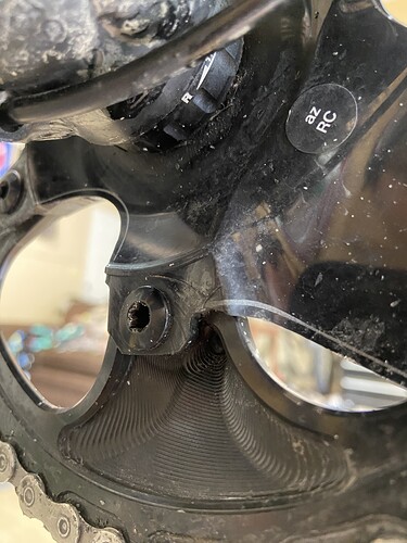

Welp folks, got around to inspecting my Dura Ace last night.
Call me part of the 0.5%
This crank is about 2-years old and 4,000-5,000 hard miles.

Can you highlight the delamination in this image? I don’t have a DA crank around to compare it to, but at first glance I’d have brushed this off as just the normally visible seams in the back of the crank.
Sean,
I actually took this half-awake and am now sitting here thinking about this. This is a multiple hairline crack, which when I watched the Shimano PSA video I swore it was on there but the video is private or taken down now.
I honestly don’t know if you could see this if the small ring was on the crank still.
None-the less here is a zoomed highlighted and non-highlighted version.
