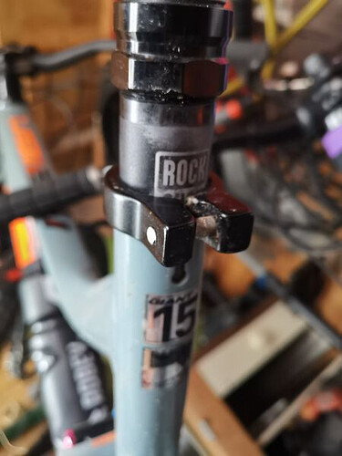

you should check how round the seatclamp is (specially when fastened, when it’s too much oval, it will apply to much pressure on the dropper, even when it’s not tight).
The “roundness” is maybe not easy to see/check, but a good indication can be how much gap you have when the clamp is tight. (the gap should be ~1mm )
For example, this one has a gap that’s way to big and also an issue with the dropper:
