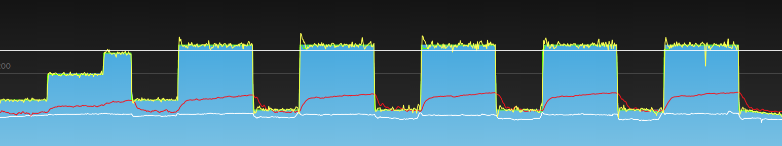

Only thing that I’m experiencing is on jumps in power, as seen below, the first ~20sec of a interval can be way too high, which hurts when there are 8 min threshold intervals but you start with 20 sec Vo2Max :wink:
Using Android. No beta version. Last update: 23th Jan 2019
your ride data looks normal, including the overshoot at start of each work interval.
That looks like a normal workout. If you want to tamp down the spikes at the start of an interval pick up your cadence ~5s before the interval change over so your legs don’t get loaded up as much on the jump. It also makes less things change at one time for the trainer and powermatch. After your comfortable at the new power you can let your cadence slide back down to where you want to be.

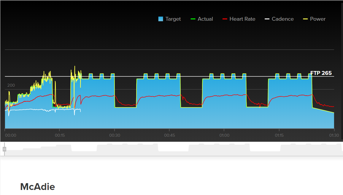

Tried the latest update on accident - used old iPad (TR updated) which still had old configuration on it and opted me into Powermatch. I set the iPad to the side so I don’t stare at it the entire time so initially just thought I was off to another rough day then figured it out. Can you tell where I turned it off! Ha.
2017 Kickr/Powertap P1’s.
Yep, that’s what I always do. Also in this workout. Makes it a lot easier on the legs
looks good to me!
When you turn powermatch off, the data looks very smooth. I only see it that smooth when using the kickr as the power source, the power reported by the kickr has a lot of smoothing applied, or it just displays what you want to see, one of the two!
