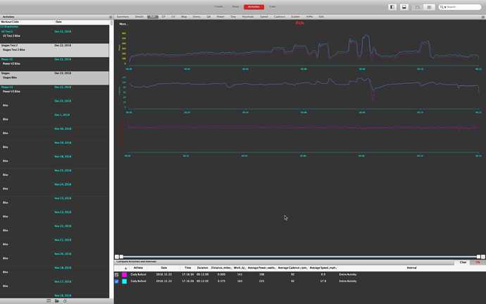

Stages ran consistently +15-25w throughout intervals, but tracked somewhat closely during low, steady power. As to be be expected.

@wodeson, what software is that?
Golden Cheetah

I did this test because upgraded my road bike’s PM to Vector 3, so I moved the Vector 2 over to the trainer bike. This shows me how much I should decrease my FTP, in stead of retesting.
Bbarrera is correct, that is Golden Cheetah, using the comparison feature.

I provided an image of using a Left Only Power Meter and Garmin Vector 2 for the same work out, showing that the Stages L Only tracks +15-25w vs Garmin Vector 2 (and Kickr Core, but that wasn’t in the oringal post either). I preformed the same test when I received the Core and made the decision to keep the Stages and Powermatch based on consistency, and I didn’t want to change FTP during a plan.
