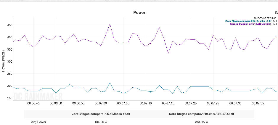

I’m running Eagle on my XC bike and using a GXP Stages L power meter.
I’ve attached some shots of a test I did this morning to compare the two power read outs.
Let me know if it’s just me? +30w on average is the norm for me.
There are two files where I used only the left leg to hold power and that seems to be accurate if you allow for drivetrain losses. WTF is going on with the rest?

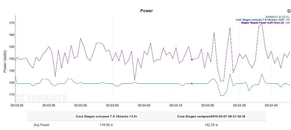

Using only my left leg.

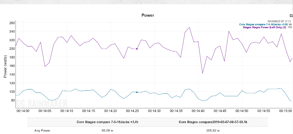

Left leg only again.

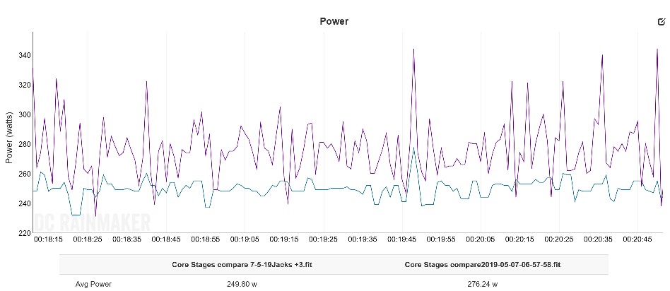

Both legs.
Both legs.

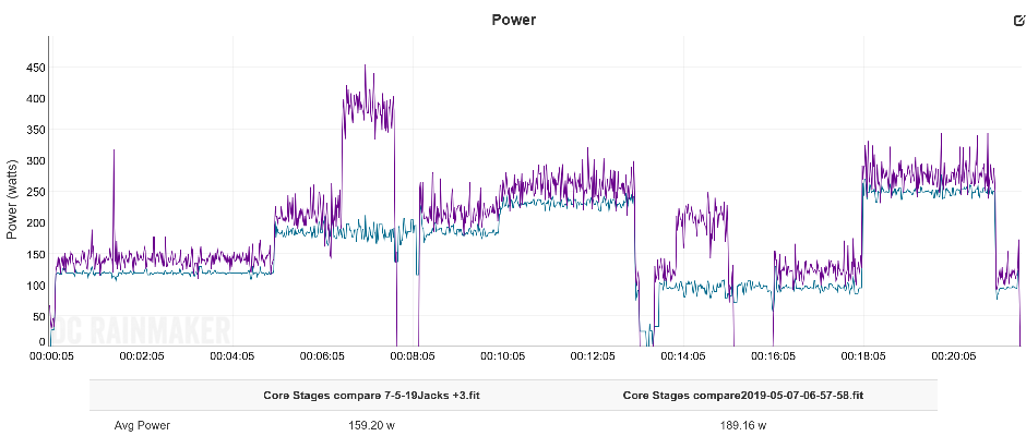

The whole file that shows you where I was pedalling with only one leg vs two. Each left leg period is followed by a short stint with the right leg only.

The final image is the entire test.
The 1st image is me using 2 legs.
The second and third are using left leg only.
The fourth and fifth are using both legs.

I actually don’t see much of a problem. The stages L measured only your left leg, and doubles the value. So if you go left only it shows 400 watts while you actually only do 200 watts on the kickr. (most of your screens look like that)
In your last screen - it looks like you had some left only (minute 6 => double watts) and directly a right only part (minute 8 => zero watts). Looks as expected to me (when I ignore your not matching comments - I can neither check that you plotted correctly, nor that you remember correctly how the workout looked like.)

I don’t think it’s anything to worry about. When you are pedalling normally, your Stages looks like it is reading slightly higher than the trainer, but this seems fairly predictable and easy to account for when you’re riding outdoors.
Your Stages will always double the power figure before sending it to your headunit.
Your Trainer will measure power at the cassette, which is from both legs. If this is 200W, then each of your legs will be doing 100W. If only pedalling with your left leg, and you want your trainer to read 200W, your left leg needs to do 200W. Your Stages measures 200W and doubles it to 400W before sending to your headunit.
Does that make sense?
Could this be a left/right imbalance issue?
The Stages is only measuring one leg, and doubling it. The Kickr is measuring both, so if your left leg is stronger than your right leg, the stages will read higher than the kickr. For example (numbers pulled from the air for sake of argument):
Kickr reads 200 W
Stages reads 230 W
Stages = 2 x Left leg power = 2 x 115 W
Kickr = Left leg + Right leg power = 115 + 85 W
L:R balance = 58:42% - high but not outside a normal range by any stretch of the imagination.
(who’d have thought simultaneous equations could be so useful :wink: )
The reason it matches (halved) when you ride with one leg only is that the right leg contribution is now not a factor.
