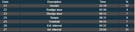

Iam a cyclist who races criteriums. About 1.5 hours with laps between 1.5 and 2.5km with a lot of corners. So high intensive. When i look at my Time in Zone in a race, i see this:
But when i see at my whole season i see this, my race and training doesnt fit:
So my conclusion is that i dont train what iam racing. So maybe is it better to train like the polarized model? It look more like my racing time in zone.

So if you agree with that statement, maybe your current training is already focused on better aerobic training? Those charts don’t speak to the vo2 and anaerobic work you did, I’m assuming a good portion of it was focused on building anaerobic capacity/power/repeatability. Some will make the argument that polarized is better aerobic training.
thanx @bbarrera i can tell you that i do to less vo2 and anaerobic work… i think 1-2 vo2max trainings a year :laughing:, the rest is racing, sweetspot, tempo and z2…
I think that the lack of vo2max and anaerobic cap more a bottleneck of my training than the kind of zones…

On a macro level, I don’t think there is a sustainable way to make the proportions of your training time in zone match up with the race. To do that you would have had to spend 150+hrs in Z7 this year as opposed to 17min, I don’t think even track sprinters are going to have that much z7 time as a proportion of their overall volume.
Thanks @Craig_G for your tips. The analysis videos indeed are helpfully but when i compare my powernumbers with other riders i always on the lower end of the zones compare other riders. I have the capacity to ride economical to the pack and leave space before corners…close gaps before corners etc
