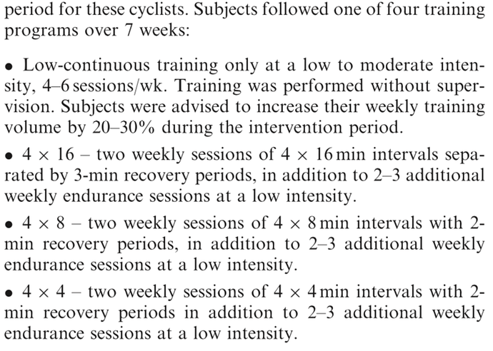

for intensity his 2013 study showed 4x8 intervals resulted in more improvements than 4x4 (it also included the 4x16 mentioned above). The athletes in that study were instructed to ride at their maximum for each interval, so there wasn’t a prescribed power. The 4x8 resulted in twice improvement of vo2max and power at 4 mmol/L lactate.
As participants were instructed to do max efforts (no Erg, no power target), these are the average % HRmax recorded for each interval type:
  • 88% HRmax average for 4x16
  • 90% HRmax average for 4x8
  • 94% HRmax average for 4x4
which for me personally, maps 4x16 to TR Sweet Spot, and 4x8 to TR’s threshold, and 4x4 to vo2max (30/30s, and 1-3 min). If that study holds true for me, that means focusing on doing threshold workouts. And to do quality threshold, I need a good base of sweet spot. My personal interpretation is: 1) establish a base of sweet spot, and then 2) build with threshold intervals.

Weekly sessions from the 2013 “adaptations-to-aerobic-interval-training_interactive-effects-of-exercise-intensity-and-total-work-duration” study:
With participants instructed to do perform maximal sustainable intensity (“isoeffort”) using their own bike on Computrainer Lab trainers.
