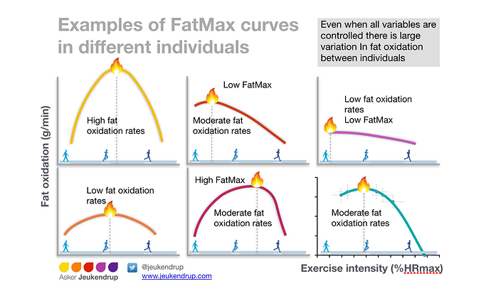

First of all, one has to consider that fat utilisation is highly individual:
Therefore, the edges of a zone with elevated fat ox is highly individual. This is the big caveat here, we trying to apply population based metrices to individuals.
However, conceptionally, I would consider a relevant fat ox range wider:

Fatmax and LT1 should be really close to each other. Asker clear states when he posted that picture in twitter that Fatmax is highly individual and that the chart did not mean fatmax was supposed to occur at 65% of HRmax.
