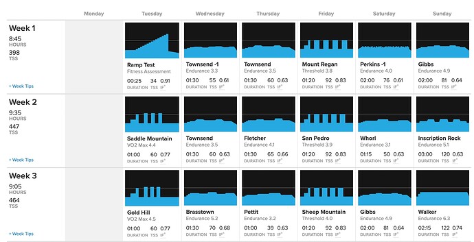

How many hours of Z2 rides are you doing per week? What are you adding to those for the intensity part of the Polarized?
Right now, it’s around 4-6 hours of Zone 2 a week. Some days I do 2 hours on a day, others I just stick to 1 hour. the weekend is always a 2 hour ride on a Saturday or longer. One day of the week has been 4 x 5 VO2 intervals at 4 minutes each interval with 10 minutes of rest between. I perform those on the road bike with power at 110-120ish% of FTP depending on my energy levels that day. The one day of the week I perform intervals recently has been 30 second sprints performed 4 times with 2 minutes of rest in between repeated around 4 times per round in a workout. At the end of a Zone 2 workout I throw in a couple 30 second sprints, maybe 2-3 at the most. It’s about as structured as I get these days.

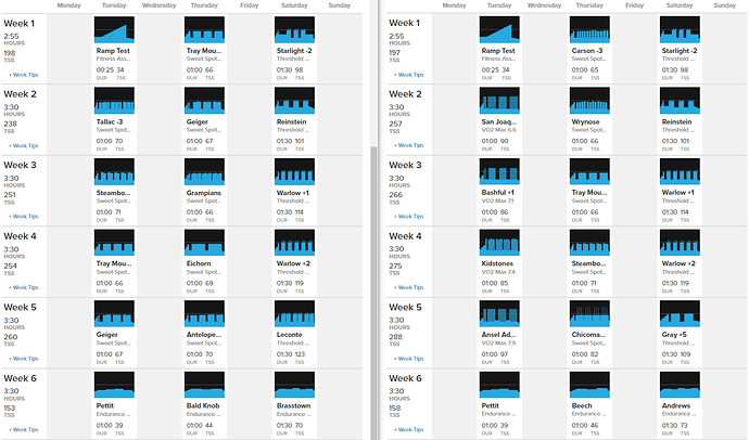

That sounds reasonable and in line with what I do: do workouts and pad them with endurance rides. Although I base my training off of a mid-volume plan. After a month-long break (my family and I went on a trip to Europe) I am currently doing a polarized block.
Personally, polarized blocks are just another tool in my tool box, and I don’t think you should be too dogmatic about it. Experiment with what works. Emphasize consistency and building habits. Stick to shared training principles like functional overload and the like.
