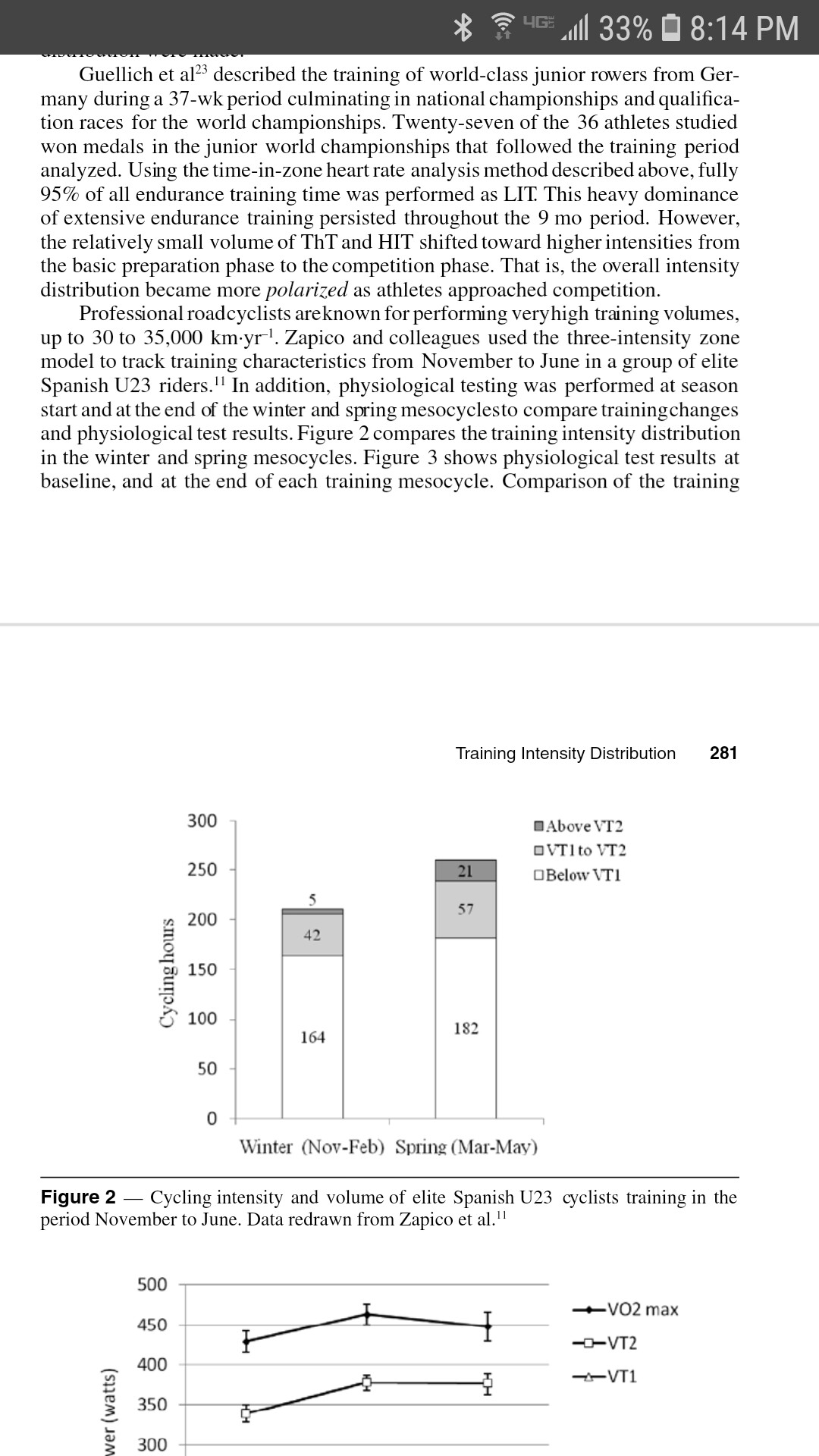

If he clearly said it was forbidden he was forgetting the case study included in his review article from 2010.
Another example of where polarized is in the eye of the beholder. (See last sentence of first paragraph.)
zone2 in 3 zone model / grey zone / “forbidden” / whatever
Yes I mentioned that interesting forgetfulness in another thread… can’t quickly find it. Believe there was an older polarized article from Seiler and it included some speculation on why the Spanish U23 train pyramidal.
