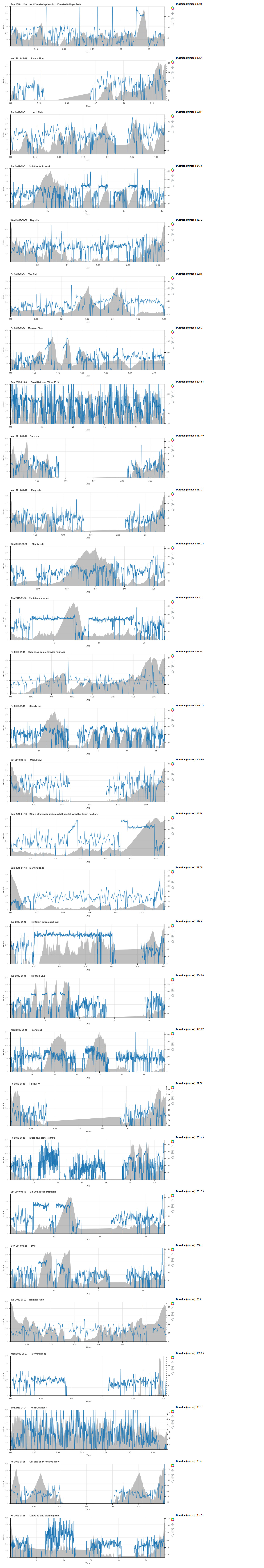

Most likely not the case. In my experience, and from examining indoor vs outdoor ride data, a 2 hour endurance ride is nearly equivalent for each setting. Even longer Z2 rides don’t diverge that much, e.g.:
This is mirrors my own kJ data — 4hrs indoors = 5hrs outdoors.
It’s more than that. Riding indoors can allow holding say 200w for 4 hours, so outdoors, anything below 200w will increase the divergence of the two rides.
