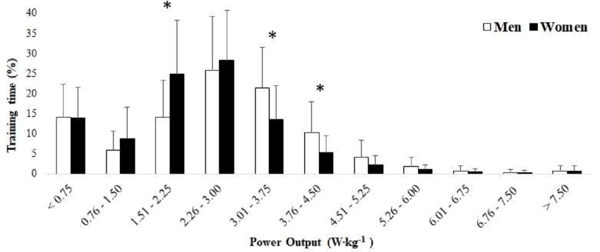

w/r to TID I find it actually more revealing to look at actual power output distribution. In the zone distributions Zone 1 is inflated by coasting or “almost-coasting” which is simply part of riding outdoors. I don’t think those threr bar pairs to the left are actual sessions with the intention of riding slow.
While it does get inflated the average IF is still only .6. The full download is on my work computer but many power charts do not include zero with z1, giving null power its own bucket. Strava is the only one i know that includes 0-x in the distribution chart. Meanwhile there is a null grouping.

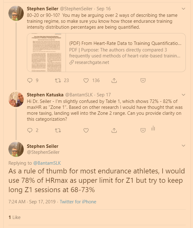

That is helpful. Especially as I am facing a long old ride tomorrow and I can feel myself procrastinating already. 68% sounds way more fun than 0.70 IF.
Can I just check, HR Max is sport specific, not the HR max I’ve recorded for any exercise? I might be repeating the question, but I want to make sure I’ve got it right.
So my running max is 194, my cycling is 184. For my long ride it I should be shooting to keep my HR between 125 and 134 i.e. 68% - 73% of my cycling HRmax.

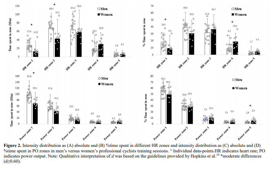

My time in zone (power) chart looks a lot like figure D. Except my total time is estimated at 1/3 to 1/4 of a pro’s week. So… how much of what we are seeing in pro training logs is first burning 2,000 calories “just riding tempo” for a few hours before or after doing the work bouts (intervals) for their day?
