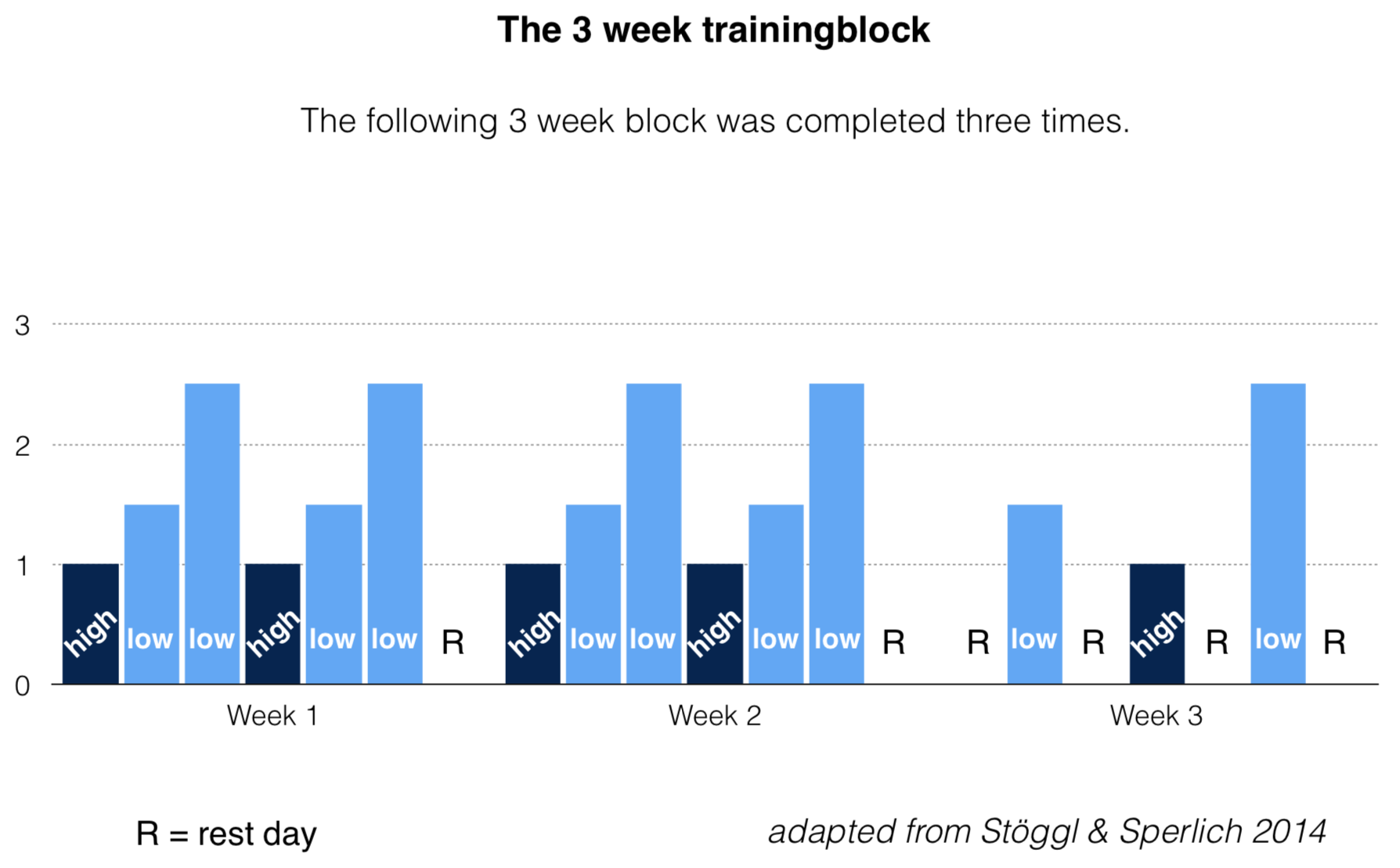

On Sept 20 I registered with wattkg.com website for the pdf of the 9 week training plan. I now have 16 well written emails saved in my “marketing examples” folder. They ended on Dec 29th with “In a few hours the Polarized Plan launch closes.” and how I was going to miss out on launch plan pricing and 2 bonus offers.
If you want to save your inbox from well written marketing emails, below I give you the free 9 week polarized training plan from Sept 2019:
Click here to reveal the secret 9 week polarized training plan
That version of the plan is based on:
  1. Stöggl T and Sperlich B. Polarized training has greater impact on key endurance variables than threshold, high intensity, or high volume training. Frontiers in Physiology, 2014;5:33 Polarized training has greater impact on key endurance variables than threshold, high intensity, or high volume training - PMC
  2. Seiler S et al. Adaptations to aerobic interval training: Interactive effects of exercise intensity and total work duration. Scandinavian Journal of Medicine and Science in Sports, 2013;23:74-83 Adaptations to aerobic interval training: interactive effects of exercise intensity and total work duration - PubMed
  3. Rønnestad BR et al. Short intervals induce superior training adaptations compared with long intervals in cyclists – An effort-matched approach. Scandinavian Journal of Medicine & Science in Sports, 2015;25:143-151 Short intervals induce superior training adaptations compared with long intervals in cyclists - an effort-matched approach - PubMed
