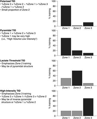

I think it is better to think in terms of 80:20 (low stress: high stress session ratio) than polarized. but that term lives its own life now out in the digital landscape. I will continue to talk about this and acknowledge that “pyramidal versus polarized” often comes down to race duration that the athlete is preparing for and other details".
Dr Stephen Seiler - March 15th 2021
It’s SESSIONS not TIZ.
So if it’s not sessions, I could do all my V02 Max training in a single mega workout once a year. Then ignore it every other day. (I’d also be dead, from 50hrs of continuous V02 Max work). That would be okay because my yearly TIZ would be perfect. My big P little p would be on point?
Of course not. Because it’s SESSIONS. The whole point of polarized training as it’s being used by actual coaches in the real world, is to better manage fatigue in athletes. A majority of easy sessions with a small amount of focused hard sessions.
This is what Dylan was harping on about, this is what many of the forum discusions were about. Breaking down a study, then showing the TIZ of a bunch of training programs does not address the FUNDAMENTAL issue.
Fatigue management of athletes on training programs. Essentially, how many hard sessions vs easy sessions.
Now, somebody with the required ability could easily breakdown the TR training programs into hard vs easy. I’m willing to bet that few, if any, are polarized by session.
Particularly, if you include sweetspot in the hard bucket, which I personally absolutely include that way. How many plans have more than two days of intensity? How many have more than three?
This I believe is the relevant question.
Go ahead, break down the TR plans into sessions

I posted this somewhere previously (maybe above) but this is the final outcome of a three week block where I was doing 2 vo2 workouts a week and the rest z2, it was 2 hard workouts to 6 z2 workouts. But the fact that people can’t really agree on a standard for this, whether it’s TIZ or ratio of sessions just makes me believe that this isn’t the magic formula so many think it is. I’m sure some of the busybodies around here will say my hard workouts weren’t hard enough or I shouldn’t have been doing z2 after a workout, or not enough z2 on the weekend. lol
No one is saying don’t add Z1 to the end. We are saying that adding Z1 to the end doesn’t make the plan Polarized, capital P.
Has Seiler specifically stated a definition of POL and has Seiler said that 80/20 TiZ isn’t as effective or isn’t POL?
I don’t think there is an official Seiler POL plan anyway. So how can we know what’s a POL plan and what isn’t.

Right it’s not clearly defined. There’s a few issues here and they mean we can’t determine a simple plan based on sessions alone.
One you mentioned, some athletes were 90/10 (like the XC’ers), and then we had others doing 78% Z1.
So there’s no 80% there. Problem again is that this time spent in the zones - actual TiZ. That’s what was measured - in hours.
From that you can roughly take 80/20 TiZ or 90/10 TiZ (not all these athletes within their groups were training exactly the same either).
Then on top of that you can throw in sessions. If Seiler’s saying 80%, well then good luck working out 80% weekly of your days on the bike because the ‘2 hard days per week’ guys are talking about is 33% of your 6 day week session time.
That’s a contradiction. So you have to extend it and plan further out to make it 80/20. Monthly, Yearly etc. Then you have rest weeks to factor in when you span it out.
Clearly TiZ is important, maybe even more important than sessions I’m thinking, yet the fixation right now is on sessions and the comments are around sessions per week.
At the end of the day, I think it comes down to the age-old advice “make your easy days easy and your hard days hard”. Something I remember reading (but still often ignoring) years ago from Joe Friel (Joe Friel's Blog: Easy Means Easy) who was just passing on learnings from long before that. Hard days could be VO2 Max work but could also be Threshold/Sweet Spot intervals depending on target events and training period etc.
I think the difficulty comes in defining “easy”, which could actually be sweet spot for those with a very strong aerobic system or much lower for others. Self-limiting power when HR/breathing is indicating that you’re moving out of your aerobic zone (even if going relatively slow) is tough to do though.
People can argue the definition of polarized however they like, but the thing that started all this was people asking for Polarized plans, meaning four days Z1 and one or two days Z3. All this other talk of including Z2 or mixing zones in workouts is just a distraction from what is generally defined as a Polarized plan and what people were asking for.
If you want to tack Z1 work onto the end of rides to add time in saddle or tss, that’s great, but it’s not what people were requesting.
