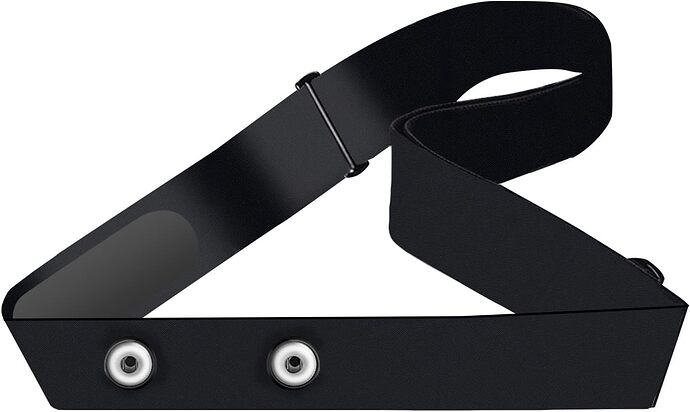

Ironically, after giving the advice to use vaseline, my own H10 started playing up. I have 2 sensors and they were both playing up the same way. So I swapped in my wife’s strap using my sensor and it is working fine again.
Therefore, I believe the vaseline trick absolutely works if you sweat profusely but ultimately, the strap will give up and need replacing. The drop outs look different between sweat related ones (very sharp drops to nothing, then quick recovery) vs strap worn out (random drops down and then slower recovery)
Because I wanted to apply for warranty for my h10 I stumbled on this thread again. My first h10 lasted 2.5 years, my second a few months, my third a few weeks.
They all seem to fail after my heat acclimatisation sessions during which I sweat profusely. Luckily I got my money back for number 2&3 and I ordered a 4th but this is starting to get annoying
Maybe it’s the heat and not the sweat?
I posted above about putting some silicone grease on the gasket. I’m thinking that it will work wonders if sweat intrusion is the issue.
My H10 is going strong after 4 years - original strap as well.
I just turn off the fan, so it’s not very hot though the lack of cooling makes me sweat profusely. I tried putting grease on the gasket but that didn’t work or maybe it was too late already
Today I got a new h10, which I used with my “old” (4 month) strap, it worked fine during the ride until I decided to sweat it out again. Then I decided to try the new strap (it’s black I prefer my orange one because I can never find black straps) and lo and behold it started working again :confused:
You are a strap killer!
My original black strap is 4 years old now. It goes wonky from time to time - like reads 50bpm no matter what I’m doing. I have to take it off the strap, let it power off and then reconnect it.
I see that new Polar straps are $35. They have red too.
Anyone ever try a non-Polar strap with their polar sensor? $13:

Did you used to leave the pod attached to the strap? My ritual is, after every use, to remove the pod, take off the strap and then rinse the strap in the shower.
My batteries last “forever” and my straps are good for about 2 years before the readings get flakey.
Similar - take pod off every time. I’m not a heavy sweater so I rinse off the strap every few weeks or when I think about it. My strap is 4 years old now.
I wonder if one is a heavy sweater whether should rise it off more often?
Yes, my first H10 was happy with the pod connected for the first few months of use. Battery stayed full, no issues. I’m not sure if it was after pairing it with my phone, but at some point the situation notably changed and the battery tanked. Then another. It seems the H10 was constantly transmitting a heartbeat that wasn’t there. I tested a second device but saw the same battery drainage. From that point would leave the pod disconnected between rides, and while it doesn’t seem ideal to pop it on and off 4-5 times a week, it does solve the battery issue. I also rinse the strap once or twice a week. I noticed a lot of the pro peloton using the Garmin, but from the reviews I’ve read people still seem to think of this as the best option so I’m rolling with it.
I’ve been using for the last 6 months with no issues after my original H10 strap fell apart (mainly from forgetting to wash it often enough)
I had this happen (high battery usage) and I would always take the pod off the band. I got a warranty replacement for this.
The replacement sometimes does this too, however the ‘factory settings’ procedure does help. I now do this every time I change batteries.
never knew one could reset the H10. thanks for the heads up.
when I first got the H10, I left my pod on in between use until I washed the strap. I ride 5x a week so the strap is washed weekly. The battery lasted < 2 months!
I was shocked, until someone advised me to remove the pod.
Since then, I can easily get 4-6 months of out each battery (depending on how frequently I use it).
Thanks for the tip, I’ll try it again. I factory reset when I got the reply from Polar that I shared above, but I’ll give that another go.
There’s also unpairing from the phone and some settings about channel transmission (dual vs single, BT vs ANT) that I believe may have some effect as well.
I think what drains the battery is something to do with it constantly scanning or sending its availability for devices to pair, as well as staying connected to my computer and sending a phantom heart rate reading when the pod is on the strap but unworn.
I think my polar strap is finally on the way out. More and more I find it showing spurious readings - like 65bpm and not changing when I know I’m over 100.
Anyone ever buy aftermarket straps or should I just buy the genuine article?
