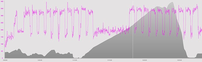

only if you don’t have control… If you have control then 40/20s are fun to do on rolling terrain:
Absolutely, even 20/40s !

@WindWarrior those intervals up there are a thing of beauty.
