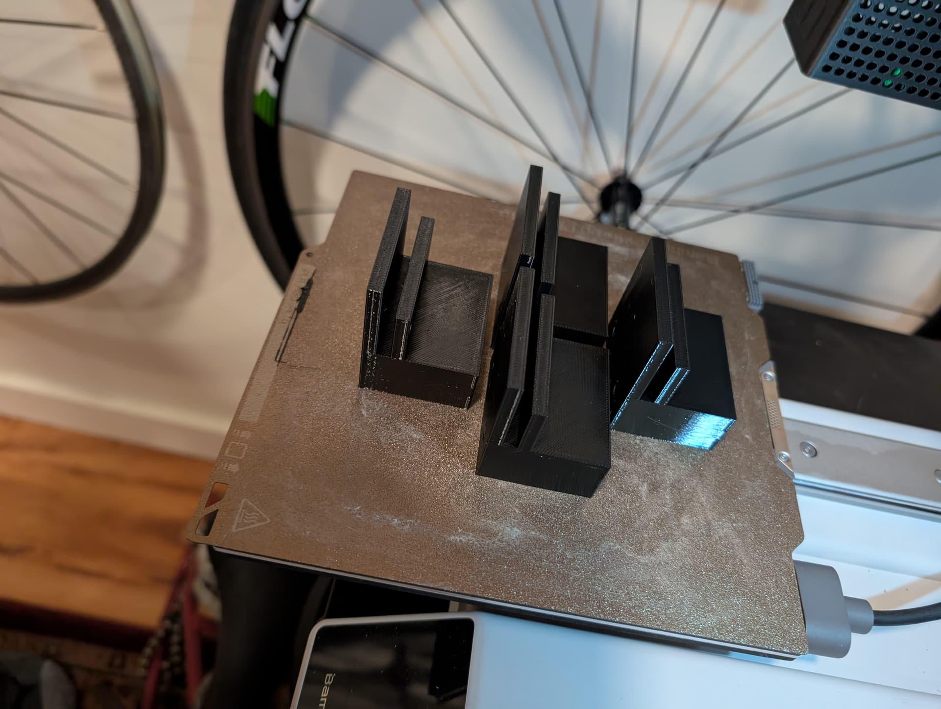

Just finished designing my first 3d printable thing to hold the mirror little over an inch off the wall. There is an outlet behind that I didn’t want to lose access to and also wanted space for the lights.

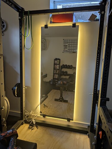

Alright went with diy of @TrekCentury idea and wow couldn’t be happier with what I came up with.
It also forced me to finally play with something like tinkercad and design my own part to 3d print.

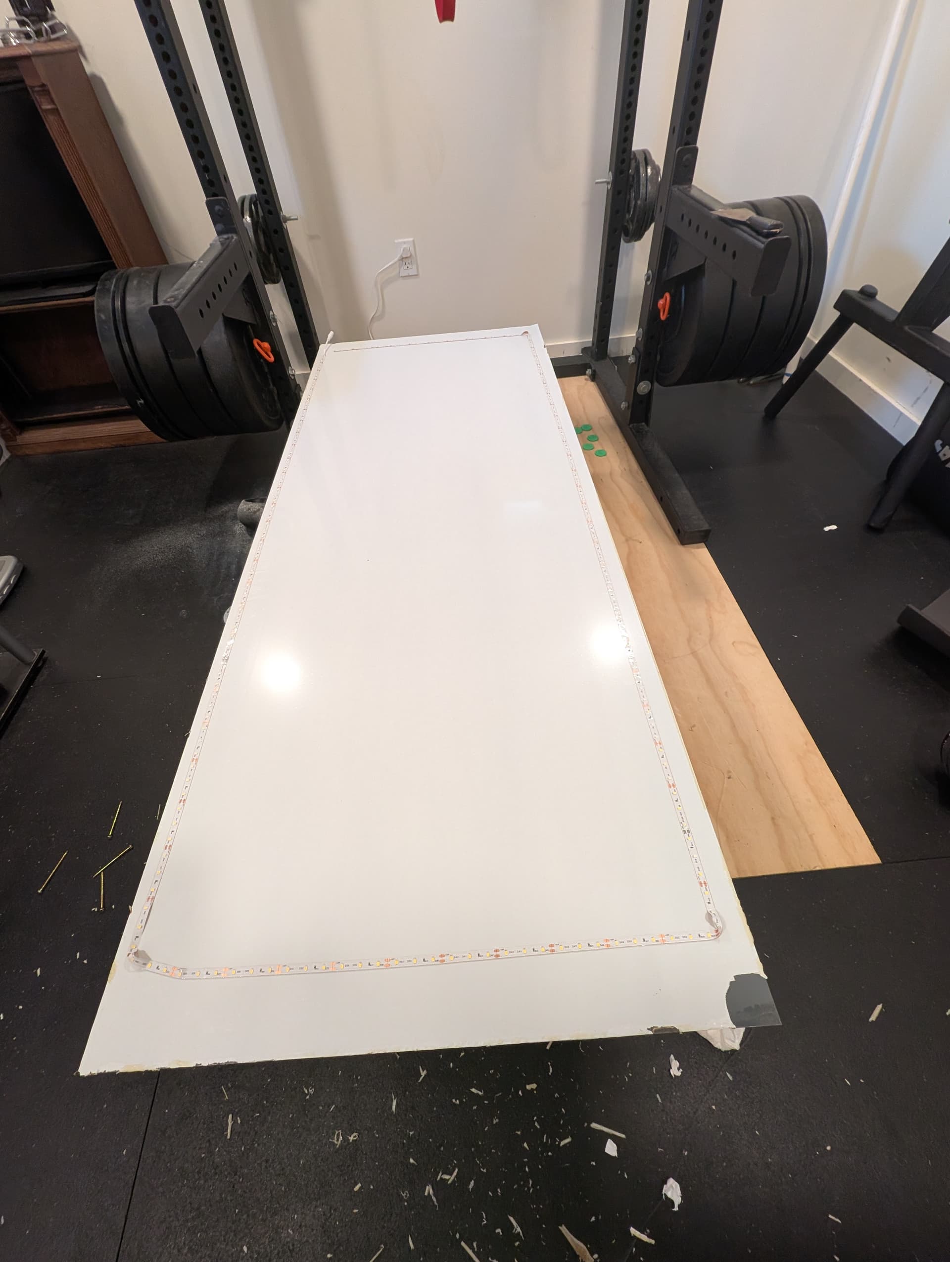

As noted above I had a mirror that came apart. It actually fell in the night , loud enough to wake me up from opposite corner of the house, onto the weight bench and did not shatter. It has been sketchily leaning against wall and with a tot in the house needed to be fixed so I planned to just mount it to the wall.
Went with a 16ft roll of 3k led strip lights. Stuck to the back of the old mirror. Designed and printed some brackets to put the mirror off the wall by about an inch. Bottom brackets are resting on the floor trim for a little extra support. 7 out of 8 screws into studs. Mirror can be slid to the side to access outlet behind it.
Sun was up by the time I got to finishing project this morning so will have to wait to see full effect tonight.
