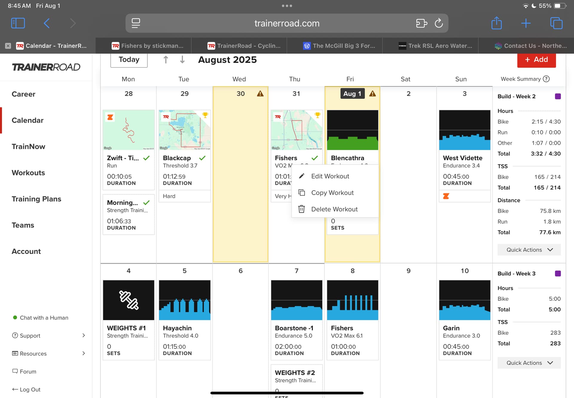

I recently had adaptive training change my VO2 workout from Fishers to Kaiser -1. Unfortunately I forgot to sync this change to my wahoo and ended up actually doing Fishers outside. When I got back the name of the workout saved as “cycling” instead of the workout name as it usually does and TrainerRoad is giving me credit for Kaiser -1 even though I didn’t do it. I can’t seem to find a way to change the associated workout. Any thoughts on how to get this workout associated with Fishers instead of Kaiser -1?

Thanks for the reply but I can’t find an option to disassociate the workout.
I had re-named the workout (in case it’s confusing) to match the ride done.
I have figured out a solution. By adding Fishers back to the calendar it allowed me to associate the workout to it and it adjusted my levels accordingly.

This is what the right-click function looks like:
Are you on an iPad? Can you try right-clicking on a different workout to see if you experience this same issue? If so, I’ll have to report it to the bugs team.
I am on an iPad. I tried right-clicking on a few other outside workouts and they all appear fine with the disassociate option. Seems like this is a one off.
