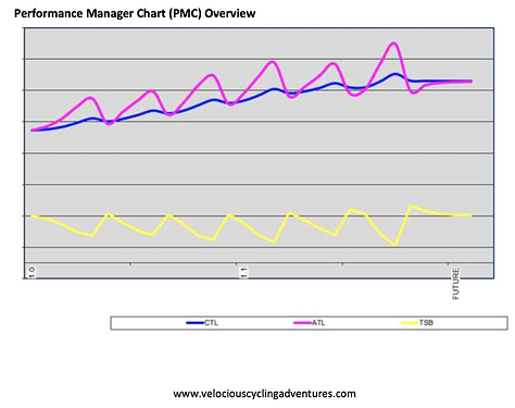

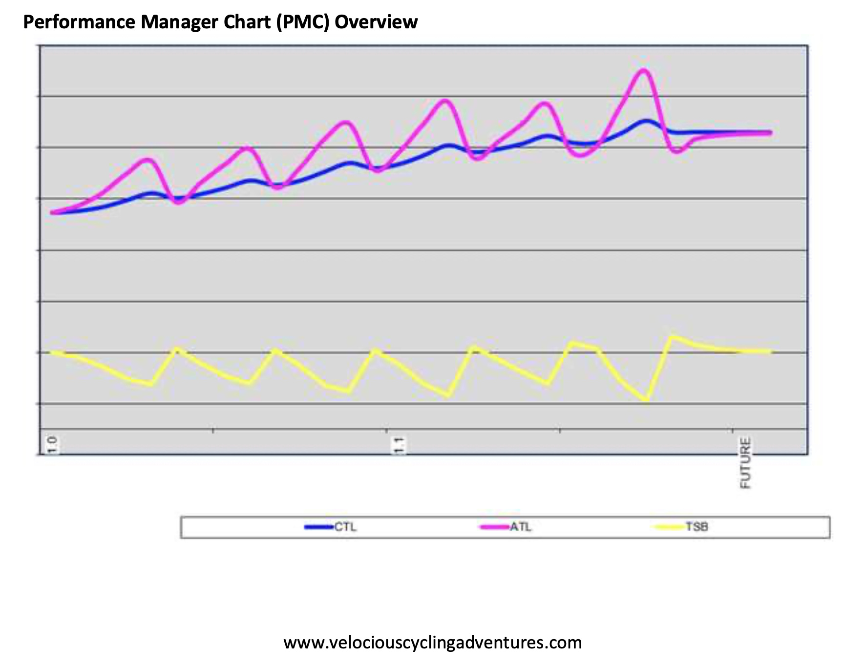

For example here is the 26 week full base (base1-base4) + build1 & build2 from VelociousCycling / Tim Cusick:
That is the 8-12 hours/week plan (weekly TSS in 350-750 range).

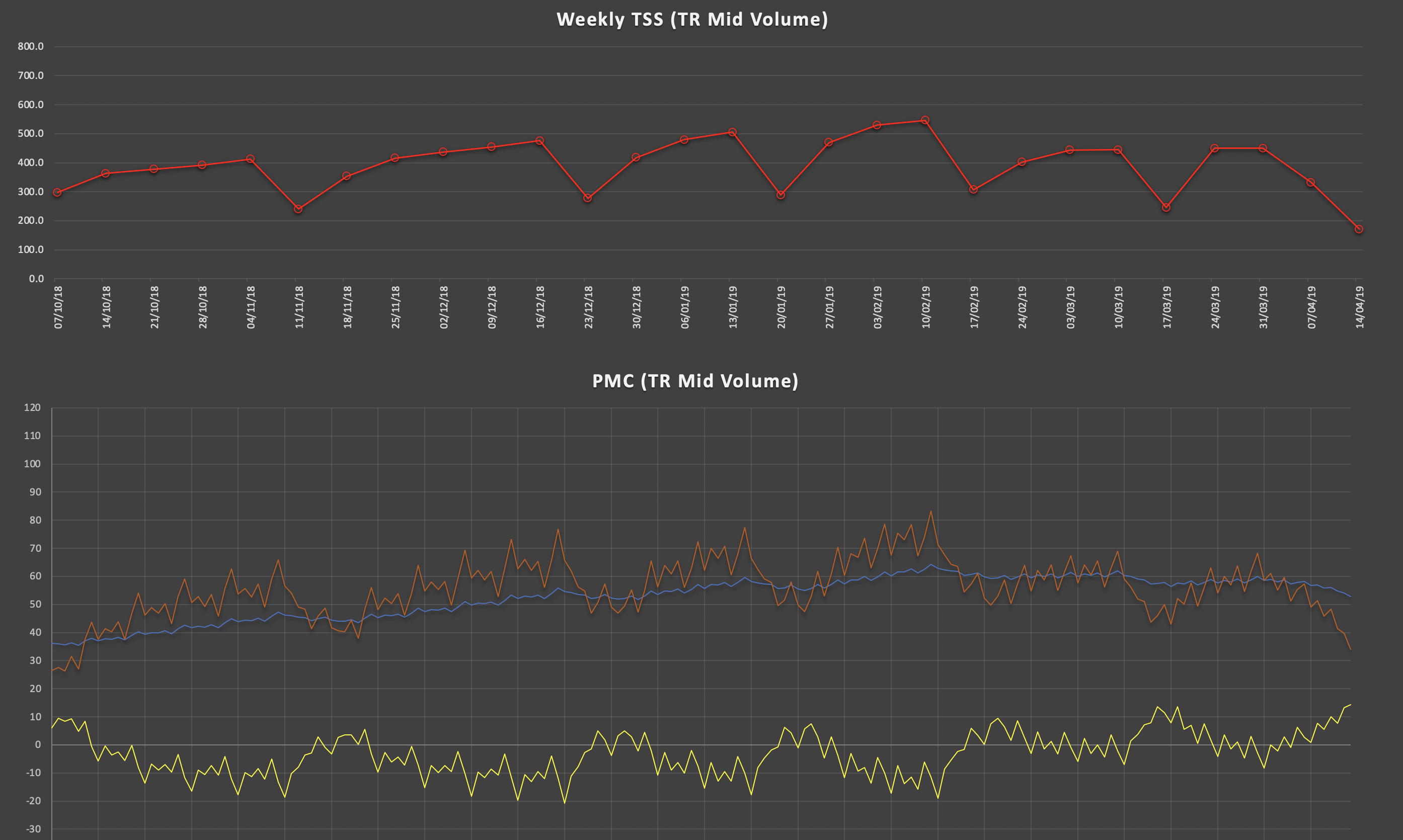

and same for TrainerRoad Mid Volume (Sweet Spot Base 1 > Sweet Spot Base 2 > General Build > Climbing Road Race)
IMHO the biggest value of tracking CTL is during the base and initial build phases. In classic periodization this is when you are NOT doing race specific interval work, it is when you are doing a lot of zone2 plus ‘advanced aerobic’ work in zone3 and zone4. This is when you are building the aerobic engine. This is when you are training to train. This is when CTL is a good proxy for the amount of aerobic development you’ve done, and in addition allows for easy comparison between the current base season and previous seasons.
