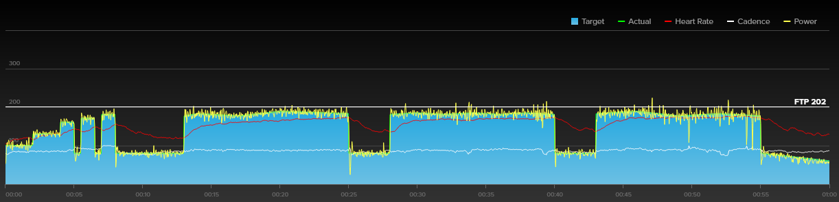

I am having the same issues with my Atom V2, especially at lower watt recovery intervals. It is slow to react and overcompensates resulting in an endless oscillating loop that is near impossible to get out of. Example below - similar workout V1 versus the new V2.
V1:
V2:

New firmware focused on ERG issues was released yesterday (v1.03.20). It makes a big difference. They are definitely getting closer to getting this right.
That’s great news. Do you have an example workout with the new fw you can share?
Old firmware:
New firmware:
It still has a tendency to drop off a cliff when it moves from interval to rest period and I had 2-3 weird drops in watts in the last interval but apart from that felt a lot better than before.
Well that looks much better tbf
It still sucks to be fair…I downloaded the new firmware yesterday and it still massively jumps over when the interval starts by up to 60 watts before coming back down…it just comes down a bit quicker.
