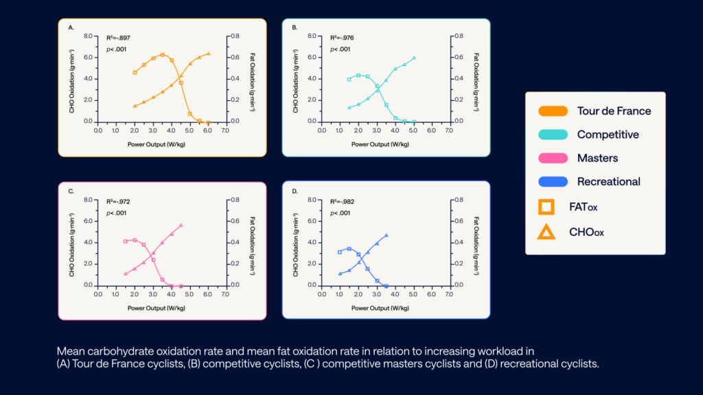

Looking at this picture, where it says you burn more fat than carbs at low power outputs, puzzles me when I see my recovery ride at 48% ftp for 60 minutes is planned to use 446 carb calories and 238 fat calories.
Worth noting, the scales on both sides of the graphs are different. Also, it’s in grams/min but 1 gram fat is 7 kcal vs 1 gram carb is 4 kcal.

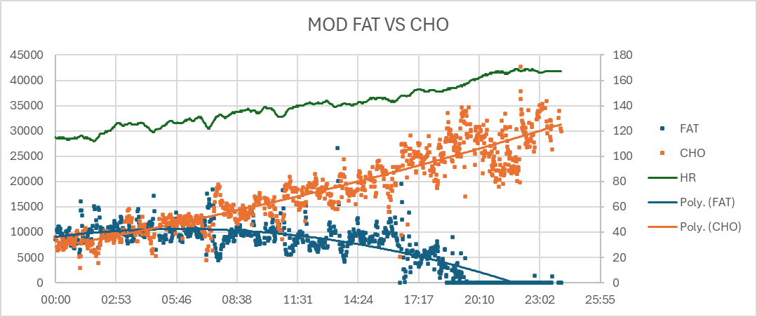

This is what mine looked like for kcal (kcal/day) form 2 lab test a few years ago:
Starts off near 50/50. All carbs by threshold (160bpm)
