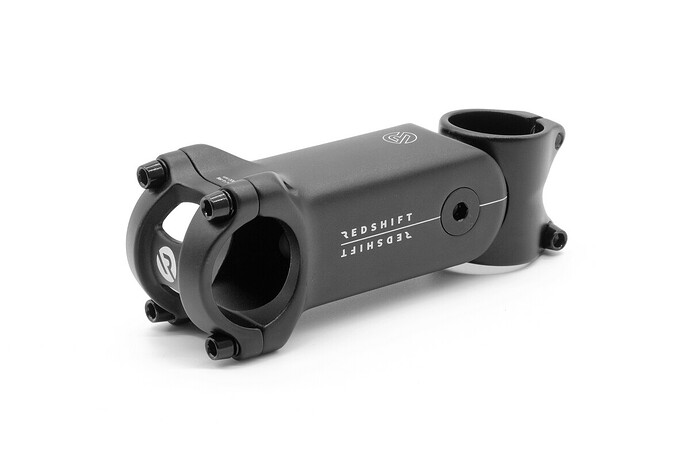

Pardon the sales pitch, but I can’t say enough good stuff about this suspension stem:
It is a perfect match to the suspension of the IsoSpeed rear on my 2015 Trek Boone. It is super solid (in the way you still control the bars) with just enough give to really take the strain out of the shoulders and arms.
I am happy to answer more questions about it, if you are interested in it.

@pwandoff That’s what I’m thinking too. Gonna start using @batwood14’s recommendation there!
@mcneese.chad Funny you mention the ShockStop—I picked one of those up a while back and wasn’t a fan, but I think it’s because I got a shorter size than my current stem and it made me feel cramped. I literally just swapped with another guy who had one that was too long, so I’m going to give it another try.
My biggest hangup with the SS stem is that I think it would be great on gravel, but I wasn’t a huge fan of how it felt on the road. My gravel bike serves double duty as an endurance bike and gravel rig right now, so that’s a bit of an issue for me. Again, though, that may be because the one I had was too short and I just felt “crunched.” And honestly, I may just need to suck it up and deal with it on the road if that’s what it takes.
On a similar note: do you find that the SS is more upright than the advertised -6 degrees? Mine seemed pretty high by comparison, and I know I had the elastomers installed correctly.

Hard to say. I have been on mine for a couple of years now, and barely remember the years before it. I could try to measure, but I don’t think it was off enough that I even noticed it.
You can take some measurements with your current setup and compare once you install the SS stem. Might need a change to spacers under the stem (assuming that you have some) and could get to the same setup within a few mm’s.
Hopefully the longer length will work better for you. It is the kind of thing that you notice a bit at first. But I think you might just start to ignore it once you ride it a while. I have a dedicated gravel setup, so other than riding it on the road for some stretches, I don’t use it on smooth stuff much. I could see how the slight motion might be an issue.
Still, I think it is worth a try. I think the mini-vibrations are massive in taking a toll on our bodies over longer rides. I think mine increased my overall comfort and is well worth the weight penalty, for my needs at least.
Good luck on your test, and don’t be afraid to play with elastomers to get the balanced feel that you want.

Perhaps try a different (stiffer) combination of elastomers.
