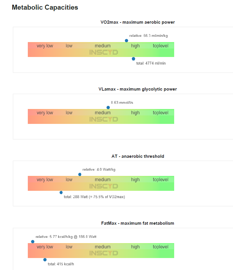

Hello guys,
I am from Germany and new to TR :).
I would like to share with you my test results from the INSCYD diagnostics to interpret the results and discuss some measures.
My Background:
I have started cycling since 2 1/2 years (22.00 kilometers, since 15.000 with structured training)
Before that, I was deep into fitness training for a period of approx. 5 years.
INSCYD: (see attached files)
VO2max: 66.3 ml/min/kg
VLamax: 0,63 mmol/l/s
Threshold: 4.0 w/kg; 288 W (75.5% of VO2max)
I do not race and I am not sure if I will. So there is no specific goal from my side regarding an event.
My main goal is just to increase my cycling fitness and therefore I would like to boost my threshold power which seems quite low compared to the given VO2max (?).
My VLamax seems in the upper range. Is that the reason for the low FTP?
Do you see in lowering this number a potential for an increase in FTP then?
Thats the only point which came in my mind. Do you see other important points in
my INSCYD report?
I realy looking forward to discussing the results and deriving an adequate training for further fitness increase. I am sure I overlooked some important coherences :smile:
Your FTP is on the lower side in relation to vo2 max (75%) it is hard to say without power curve but you should have some headroom to push from below - so I would focus on a lot of aerobic work, lot of long Z2, sst and threshold work. When doing vo2 max - longer intervals 4-8 min.
The other aspect is that simply it is your phenotype - more punchy rider so play your strengths.
Ok. Makes sense to me.
My bests so far @72kg
5 s: 1100W
1 min: 645W
5 min: 415W
20 min: 320 W
1h: 290W
Would you say an example training week can look like this:
SST 2x20 min, 1 set with low cadence, + endurance (4h ride, twice a week)
VO2 max, 4x8 min + endurance (4h ride, once a week)
Endurance ride with a sprint all 30 min (5h, once a week)

First of all, an FTP of 4.0 W/kg isn’t low. But you’re right that compared to your vo2max, there seems to be space for it to increase. For that to happen, you probably need sustained intervals under threshold - think the inscyd guys recommend around LT1.
Your VLamax will probably come down as a consequence of doing a lot of sustained work, but to be honest, I wouldn’t worry about that number right now and look more at the VO2max/FTP contribution.

What do you excatly mean by focus more at the VO2max/FTP instead of VLamax decrease?
You recommend to continue with short V02 max intervals instead of a big focus on sustained under threshold intervals?
No, I mean what you said - at the moment, you FTP seems low compared to your VO2max, so focus on bringing FTP up “from below”, ie with sustained sub-FTP work. Once it goes to about 85% of VO2max, that might not work anymore, and you’ll need to improve VO2max, before you can raise FTP further.
I wouldn’t focus on the lactate stuff, it’s hard to measure at home, and personally I’m not convinced vlamax means much.
Now I got your point. Makes sense to me. Thanks!
I would definitely go way longer. 2x20 is basic workout to start with. Go extensive, start with 2x20 and add time or intervals or both every workout - 2x20, 3x20, 2x30, 4x20, 2x40 and mix with threshold (4x10, 5x10, 3x15, 4x15, 3x20 etc). I would try full aerobic work - only sst, threshold and z2. Your short power is very good so probably needs only some maintenance not regular training - so touch it sometimes but I would not do this every week as you want to maximise the time below FTP.
But I am not a coach, so probably there are some more qualified users here that will have different opinion.
