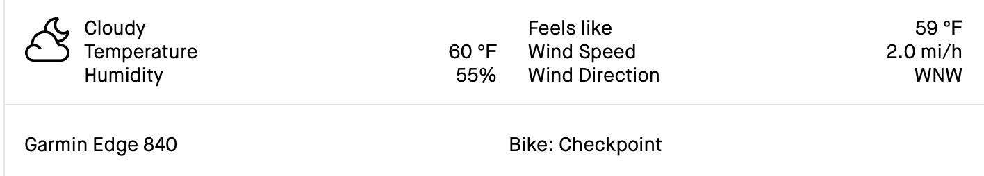

Checkpoint road/gravel bike with 48mm (measured) S-Works Pathfinders. Definitely not a road tire.

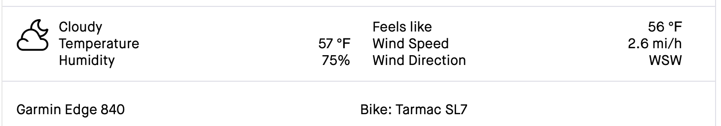

Tarmac SL7 road bike with 33mm (measured) GP5000 All Season TR tires.

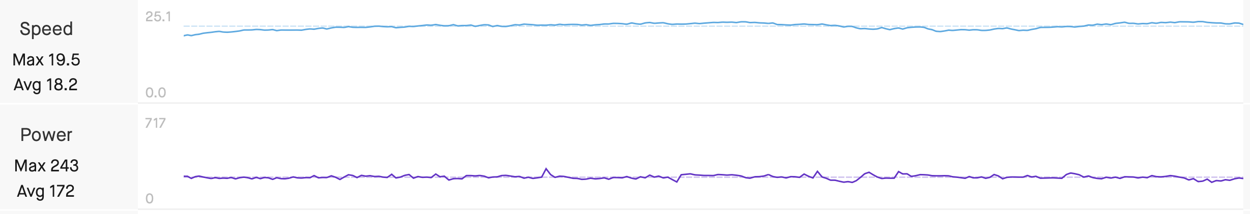

2mph WNW wind :arrow_lower_right: riding west :arrow_left: into headwind: Checkpoint

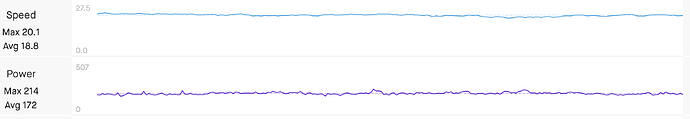

2.6mph WSW :arrow_upper_right: riding west :arrow_left: : into headwind: Tarmac

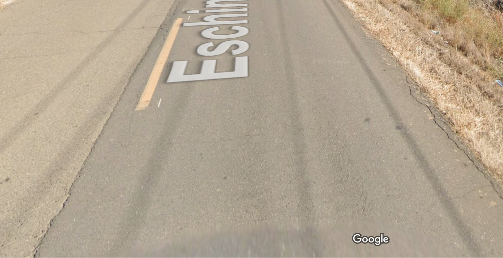

ok road surface:

2mph WNW wind :arrow_lower_right: riding North :arrow_up: into headwind: Checkpoint
2.6mph WSW :arrow_upper_right: riding North :arrow_up: with slight tailwind: Tarmac
poor road surface:
Well that is a head scratcher. Usual erg-like power, just like the previous westbound segment above.
Didn’t control for body position, however I’m usually practicing the same alternating good/better aero position during endurance rides.
