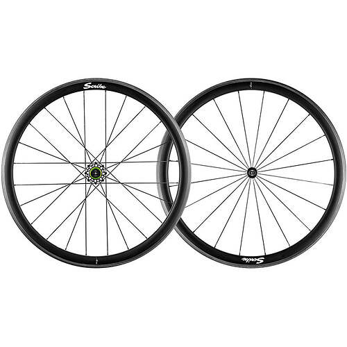

I had my eye on some Scribe 38’s…
Then I came across the idea of mixed rim depth with 38 front and 50 rear…
I’m really looking to see if there is a real benefit in a larger rear rim depth and a shallower front, I know most benefits would come from the front depth but my general riding requirements will not need that based on my description of that at the start of this thread, wind, climbing etc.
