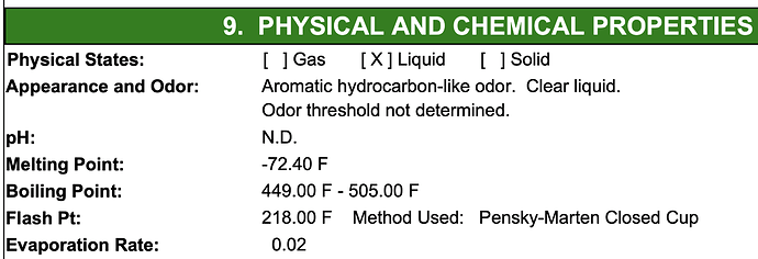

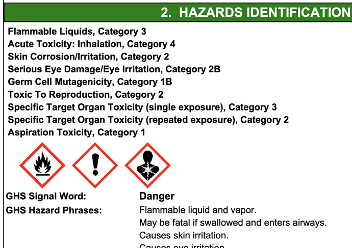

but you can pull up the Safety Data Sheet (SDS) from the Home Depot website https://images.thdstatic.com/catalog/pdfImages/38/38f67187-cf0a-42c7-b0ab-171cb34da1df.pdf
A few snippets:
Ok looks like some nasty nasty chemical hazards. I don’t know what it means and stopped asking my daughter questions after she gave me the same high-level environmental reasons that I posted above.
Anyways the list of hazards goes on and on… Lets skip ahead to the formulation:
Stoddard solvent and Benzene.
