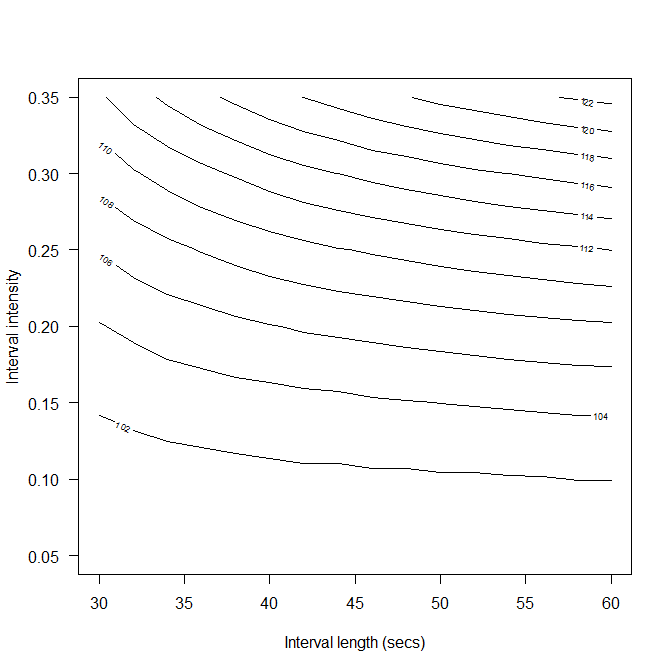

For symmetric equal-length on/offs (that is, X seconds on/ X seconds off, where the on is Y% above FTP and the off is Y% below FTP), TSS increases faster when you boost intensity than when you lengthen the interval length.
(Here, .05 means your on interval is 5% higher than FTP and your off is 5% below FTP; .25 means your on interval is 25% higher than FTP and your off is 25% below).
FTP is not your hour power
So if I understand correctly, 30 s on/off intervals at 132%/68% of FTP is the “cheat code”. Any takers?
