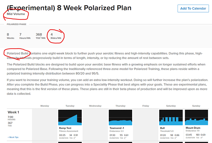

Polarised build is 4 days per week. 1 VO2 max. 1 Threshold. 2 Endurance.
Where are you seeing Pol Build at 4 days? I’m not seeing that when I look at the dropdown options for the build segment on my PB plan on the calendar. Shows 2 endurance, and one intensity.
you have to select it from the Pol plan options, and for that you have to select experimental beta options in your profile. Pol plans dont appear in Plan Builder as they’re still classed as experimental by TR
… and 4 days is Polarised Build Mid Volume
Ah, that’s what I was missing. Had all the other parts figured out as that’s how I did Exp Pol LV for base 1 and base 2. When I originally built the plan there was no Exp Pol build. And somehow I was thinking you wrote LV was 4 workouts/week.
