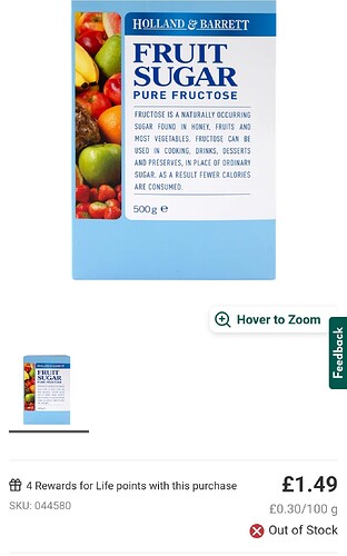

Not UK, but Ireland… Maltodextrin from Myprotein or BulkPowders. Bulk used to do Fructose, but don’t (on their .ie site at least) post-brexit, so I buy from Holland and Barrett. Electrolyte powder I buy from Bulk.

No out of stock here too now I look. I did home delivery the last time, so stocked up! I used to be able to by 5kg of it with Bulk!
