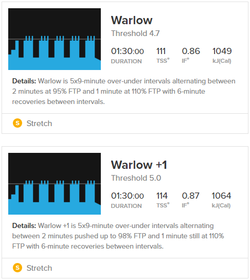

Now that my TR plans underwent a once-off adjustment based on AI/ML, I’m always checking out the next ride and wondering what kind of pain is ahead. Warlow +1 is coming up with not a very encouraging passing rate looking at recent attempts. How much worse is it than Warlow 0 for those who tried both?
Warlow+1 looks tough. Almost VO2 in nature?
Warlow looks like a pretty standard threshold over-under workout.
I haven’t done either sorry, but I was interested enough to look and will be interested to see how you go. good luck!
It appears the biggest difference is the “under” is at 95% FTP on the regular, and 98% FTP on the +1 version. So the plus one is more “at-over” with both having a VO2 level 110% “over” that is just one minute long. They have the same duration and power everywhere else that I see.
They are rated very close in the new Workout Levels (0.3 difference) so not massive, but could be a pass/fail depending on your actual Progression Level and history with over-under
Yea, I saw the difference, but I have learned by now that my perception of how comparable workouts differ can be vastly different depending on whether I have done them or not. If not, I have in the past vastly underestimated the effect of small differences.
I completed Warlow last weekend, it was definitely tough. I did have problems out side my control that influenced that workout. Like, I lost power in my house luckily during a rest interval, it then switched back on thankfully. Then minutes later in the middle of an interval a shelf just gave out in my garage. :man_facepalming:
It was tough I gave myself a 4/5, I tried to stay in tune with on screen instructions having me stand for each “over” and those are what always get me.
