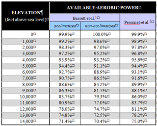

I’m sure many of you have seen this table comparing performance at different altitudes:
I live at a little over 5,000’ elevation and I sometimes ride/train at elevations between 6,000’ and 10,000.’
While the chart is great at helping determine what my performance might be if I went to sea level or how someone at sea level might perform (acclimated or not) at a higher elevation, it doesn’t directly address the case of someone acclimated 5,000’ doing unacclimated work at 8,000’ for example. I definitely have some ideas for how to interpret this for my case, but I am interested in other interpretations. It seems like it might be a not so uncommon scenario.

Does it matter if you are acclimated? If you aren’t you go slower… if you are you go faster. Your mark simply is an algorithm of what the equivalent performance would be.

6-8% decline in VO2max for every 1000m gain.
It’s not perfect math, the gap between someone living at 8000‘ and someone living at sea level, both riding at 8000‘ isn’t much (84% vs 88%).
So since you are better acclimatized than „not-acclimatized“ but not fully acclimatized to 8000‘, your power should be somewhat in the middle of the two values (86% give or take).

Thanks for the input about the percentages. I do the vast majority of my training indoor at home, but I love to get out, especially in the high mountains. I’m mostly looking for a way to evaluate those efforts.
