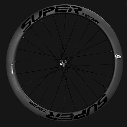

A friend has been on SuperTeam wheels for a couple of years and is very happy with them.
