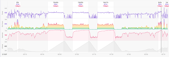

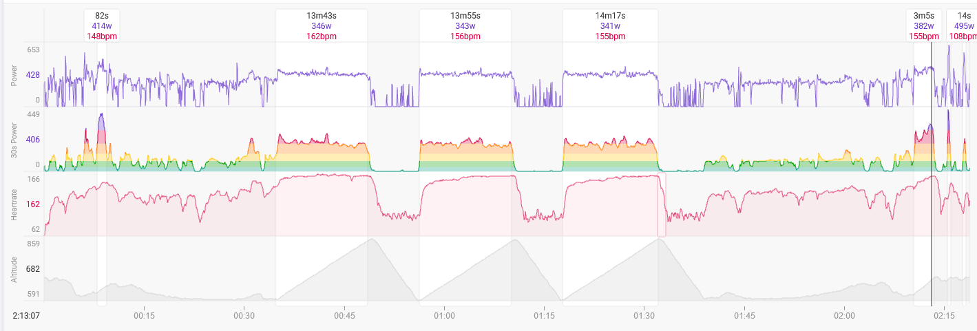

I try to do my interval work outdoors. I choose the climb according to what I want to train. This week I wanted to do threshold intervals:
The length of the climb and number of repetitions dictates intensity. Of course, you have to know what you can pedal for this duration. But this is something experience tells.
Indoors I do my intervals in slope mode, never in erg mode. 1min zone5, 3min sst (or so) for example. Actual wattage will simply ensue:

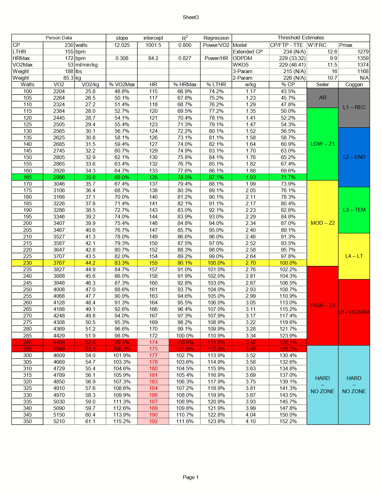

Here’s my data based on the image you posted earlier in the thread. The VO2 utilization is based off of metabolic cart readings I’ve collected over the past 6 or so weeks. Yesterday I managed to record a portion of an outdoor ride on my metabolic cart and saw an average of 225watts, 3,700 ml/min VO2, and 0.99RER during 15 minutes of one of my intervals. If I was motivated, I likely would have hit RER=1.0 at a bit higher VO2.
