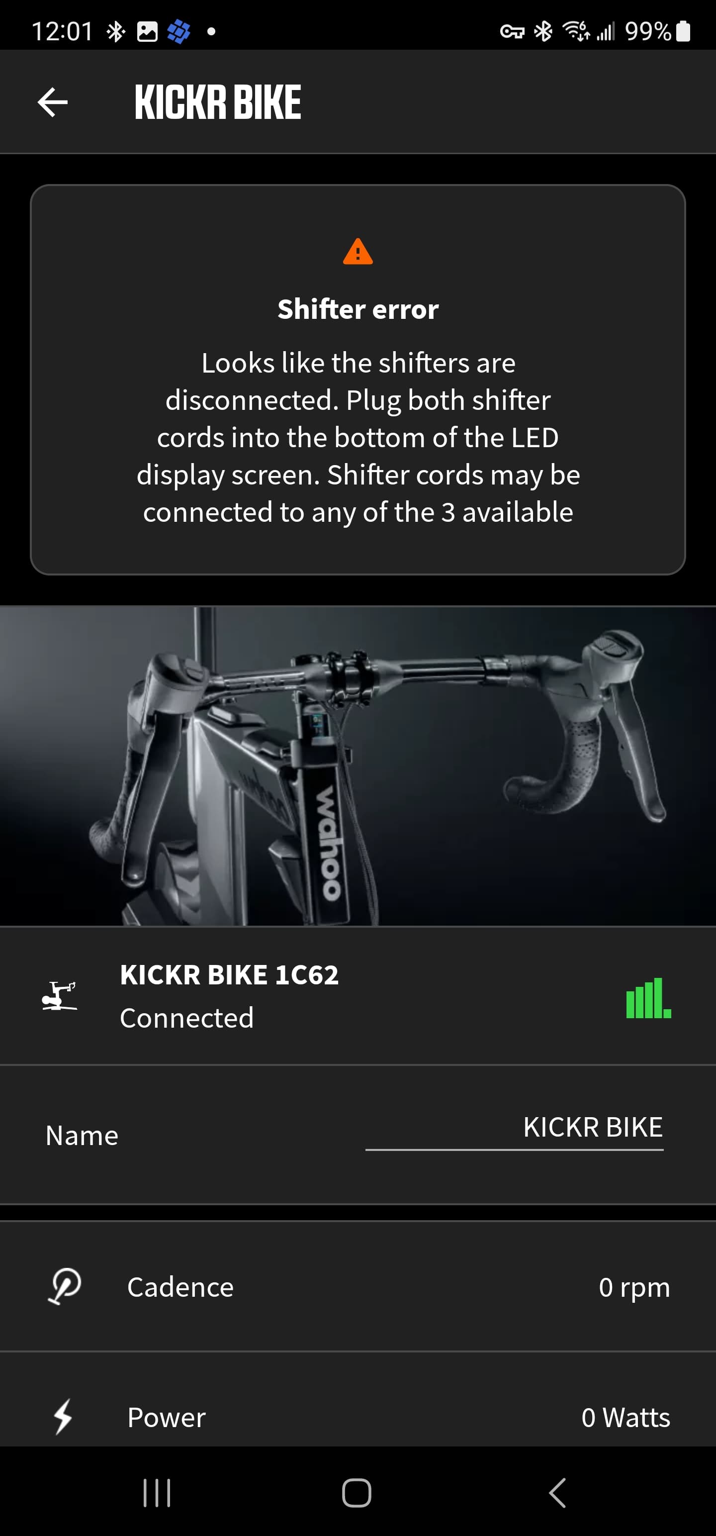

So it seems my shifters have stopped working.
Everything was fine and I completed Wahoo SYSTM Nine Hammers using a combination of ERG and Resistance mode. I then did a few TR workouts in ERG mode and noticed I couldn’t adjust tilt. I figured it was some glitch with TR, so paused, turned the bike on and off, but no luck.
Today I went into the Wahoo app and it says shifters aren’t connected. They are, but I unplugged them and plugged them back in several times but no luck.
I put in a ticket with Wahoo
Follow up to my last post. I contact Wahoo support. They wanted some pictures of the connectors at the end of the cables to ensure they weren’t dirty and therefore not connecting. I knew this wasn’t the problem as the bike is in pristine condition, but obliged and went to take the pictures. At the same time I unplugged the bike again. I had unplugged it previously to see if this would fix the connection issue but it hadn’t.
Well after plugging the shifters back in and plugging the bike back in, all of a sudden the tilt controls starting working again and everything seems back to “normal”. I email Wahoo and let them know.
I will monitor moving forward but it seems this is some sort of a software/firmware glitch. The problem started after I had completed a Wahoo SYSTM workout (Nine Hammers) where I was doing some of the intervals in “resistance” mode but then flipping back to ERG. I had no issues during that workout but when I went to use TR in the following days the shifters were not working.
We’ll see if this happens again or not.

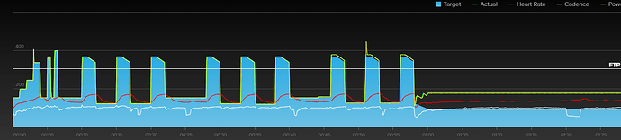

I have power smoothing on because it makes me sleep better at night. I’ve had this kickr bike for a few months. Things have been really smooth. However today, it gripped me hard on one of my warmup intervals as you can see with that spike from 306 to 955 for two seconds. This was the second ride this happened and I included the previous workout where this actually happened twice. I’m obviously in erg. Has anyone had any wierd spikes like this with their kickr?
Not yet fingers crossed. I’ve had it for a year and only use erg mode.
