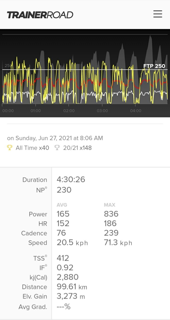

Redemption ride today, similar kinds of power/time outputs required. Holding VO2 power is much easier on hills.
I’m picking your FTP is slightly understated at 250? 0.92 seems reasonably high for four and a half hours? Admittedly I’m no expert at power analysis, and your Average Power is a lot lower, but still that’s a bunch ![]()
Yeah, some moving/stationary funkiness going on with the ride. Total time was 5 hours. Possibly making actual IF lower?
It was a very hard effort, full on race pace on the climbs, but also lots of rest on the descents.
Intervals.icu has my ftp at 258, which is probably about right.
